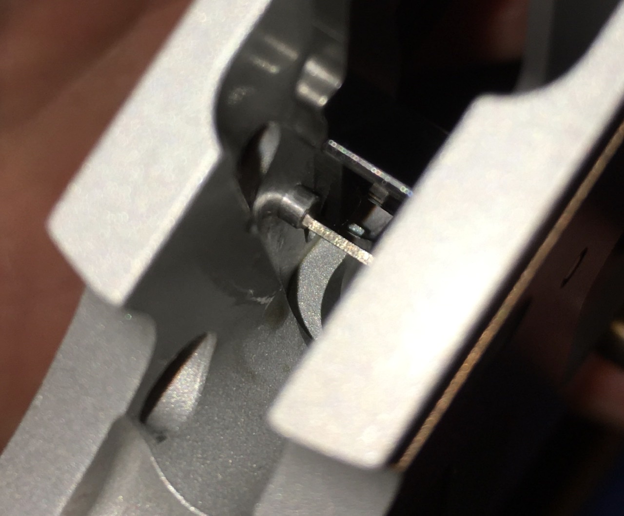

Sear Spring Fitment Issue
Sear spring makes contact with the ejector limit pin and actually gets ‘stuck’ under it causing tension to be lost on the ejector. Factory sear spring functions flawlessly. Tried emailing the m*carbo ‘help’ Address but no contact after several days. Sure would be nice to see if a replacement fixes my problem... just saying...
