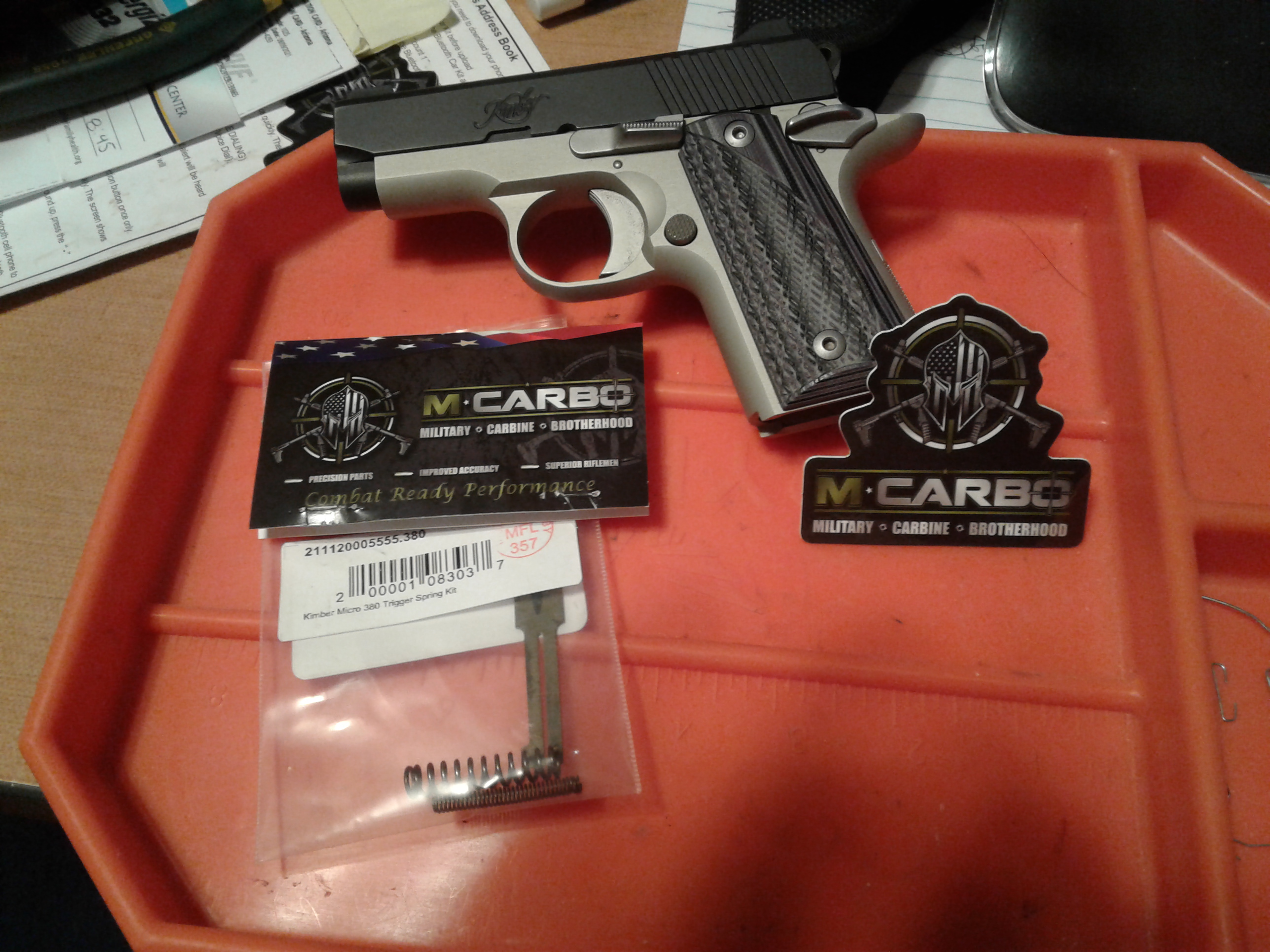

Took me about 1 hour a little bit of frustration. However, overall went very smooth. I. Also changed out the recoil spring, I went and shot 100 rounds clearly a softening of the recoil. Which was always a problem with the Kimber micron. Accuracy improved dramatically with the softer trigger pull. Ps...first time I completely took apart any gun and it went great.

Simple installation after watching the video. Absolutely no problems... And the result is so nice. Nice clean, crisp break at 50% of the original pull weight. Happy Happy
Recently bought 2 of Kimber trigger kits, one for my Micro 9 and one for my wife's 380 Micro. Watched the video several times for reference. Installation was very easy except for the sear spring was tricky to get aligned. After several hundred rounds the factory trigger was a little more than 7 lbs. and after installation it is slightly over 4 lbs. Definitely worth the money!! Both pistols are more comfortable for us to shoot and accuracy has improved by the lighter pull and crisp trigger.

Researched and purchased the above spring kit. Watched the video which was a great help. Installed kit. Took it to my local gunsmith for trigger pull test. From stock 6lbs down to 4lbs. Honey smooth pull with good reset. Going to order for my Sig and Glock.

Super easy to install took me about 15 minutes. I started out at around 6.5 pounds after I was finished I measured again and was right around 4 pounds. I’m super excited for some range time. Awesome product good job guys. God bless and thank you.

Product as advertised, communications great, video priceless. Trigger results are very acceptable, was hoping for a lighter pull yet. From 7,3 lbs down to 4.6 lbs. Installation, for me wasn't anywhere as easy as the video showed, I ended up re-installing the sear and ejector, then the main spring. Tricky, but it worked. Recommend? absolutely!

I found it easer to install the sear before the ejector, installed it using punch. It holds the spring back enough to make the ejector go in easy. Put pin in ejector and slowly pushed punch out.
