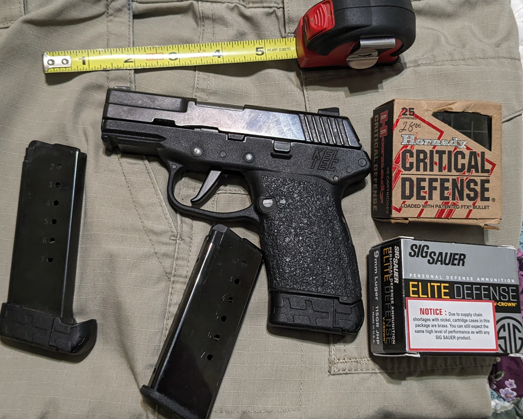

It's a vast improvement over the original But for some reason I was getting Light primer strikes On the third and fourth round in the magazine but after about 50 roundsIt started function correctly. (115gr Hornady Critical Defense &115gr Sig Sauer Elite Defense) Break-In period?, I don't think so as the Pistol already has about 600 rounds Pistol already has about 600 rounds Hornady CD through it already and I've been carrying it for over 10yrs now. But hey it works now!
