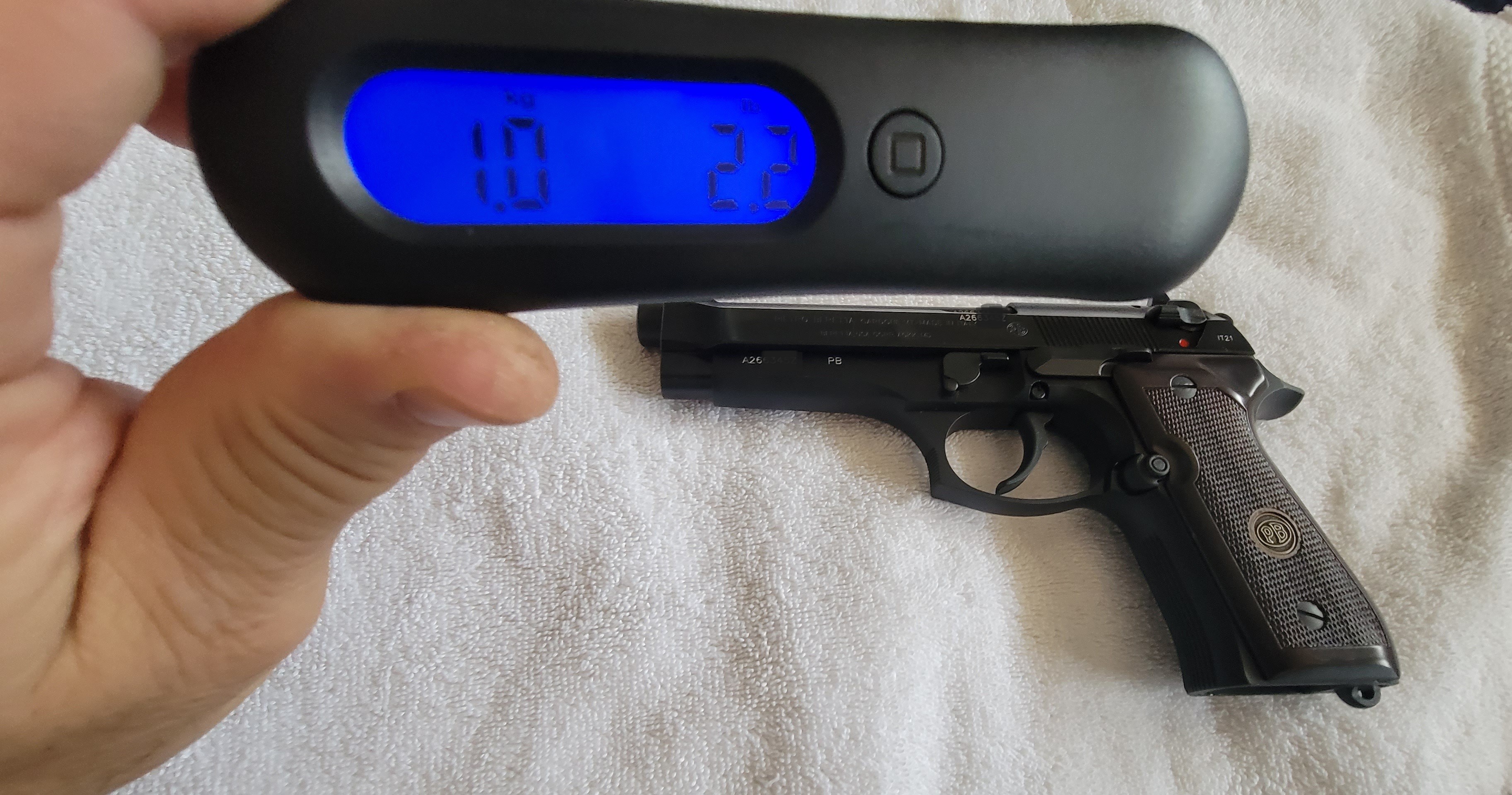

Excellent kit... as good of feel as LT
I previously owned a Langdon Tactical 92G, which had the smoothest DA/SA feel of any DA gun I've owned or used, and that's saying something.
I sold that gun (didn’t want to have that much cheddar tied up in a 92 series pistol), and when I recently acquired a 2022 date Italian 92FS, it was decision time... go with LT's trigger job in a bag, or MCarbo's package.
I obviously chose Mcarbo, mainly due to its way lower price, but also because I've installed many Mcarbo spring sets, and had confidence in the results (as well as the typically good install videos).
In addition to the Mcarbo spring kit, I also added another MCarbo polishing kit (my first was almost used up), as well as Beretta's very reasonably-priced skeletonized hammer, and the result was impressive.
Stock, my 92FS registered a 10.2-pound DA pull, and 4.2 SA pull. After, DA is now a super smooth 6.2 pound pull, and SA is a very impressively crisp 2.2 pound pull.
I'd still say the LT 92G had a bit better trigger feel, but at 1/3 the cost, I'm definitely not complaining!
Install was one of the easier jobs I've done, although my specific pistol had a different style pin holding in the hammer spring (a roll pin), and the I wish there was better instruction as to orientation of the seer when reinstalling.
All-in-all, another successful job and continued happy customer.
