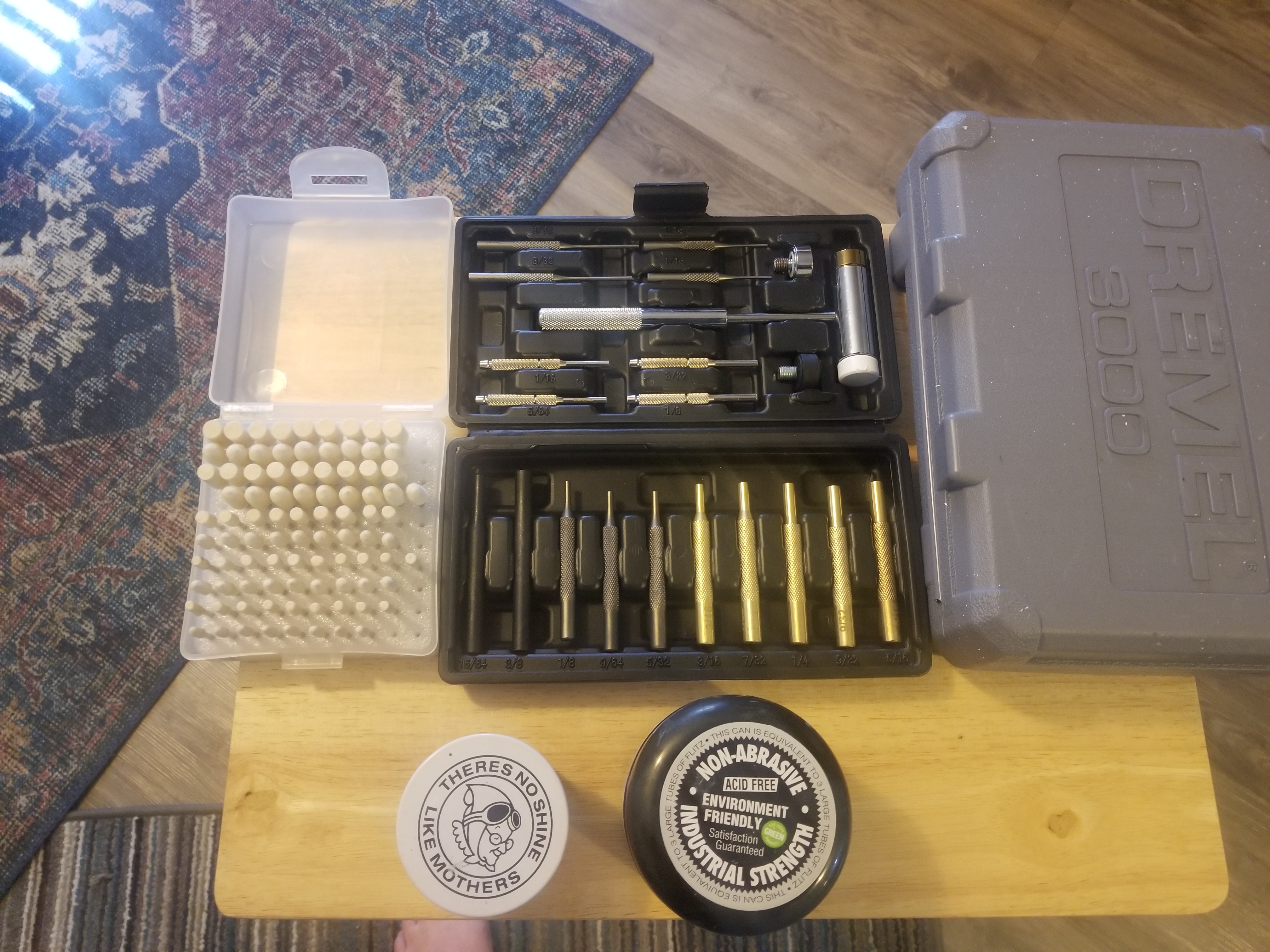

Follow video step by step polish all parts recommended spent 20 to 25 minutes or less per part reassemble drastic improvement in double action . in single action had no way to check trigger pull but I'm guessing about 2 pounds under 21/2 pounds in the sweet sweet spot . I purchased polishing bits came in different sizes highly recommend. Purchase microfiber towels. Purchase fritz and mother's polish. Used dremel. And used gunsmith punch set . Here's picture.
