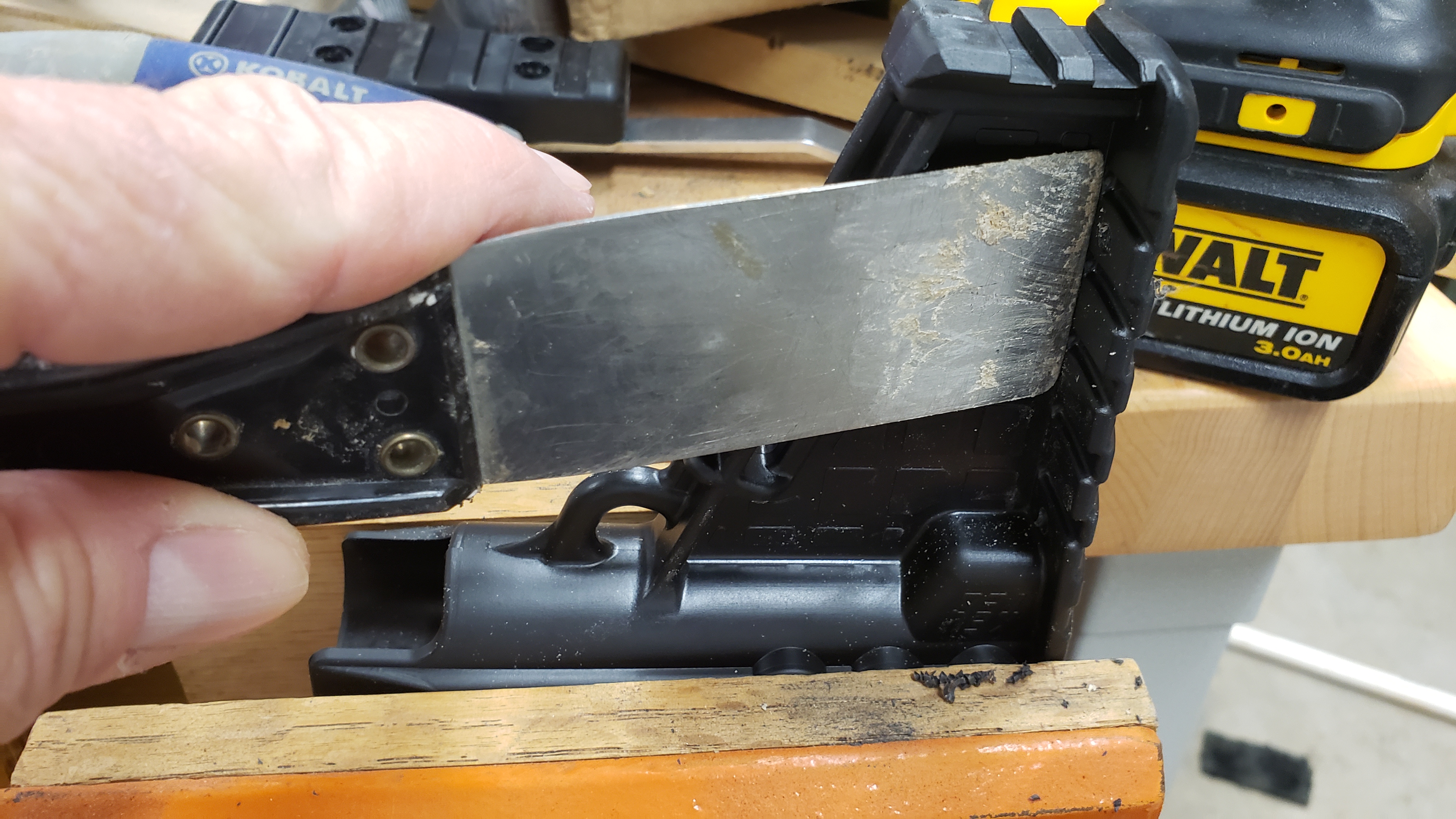

Cool pad. Helps lengthen the rife and give some felt recoil. How ever, when you watch the video on how to install, please don't run your drill bit into the buttstock and scare it up. I sued a putty knife blade held against the buttstock so when the drill penetrates it can't scare up the buttstock.
