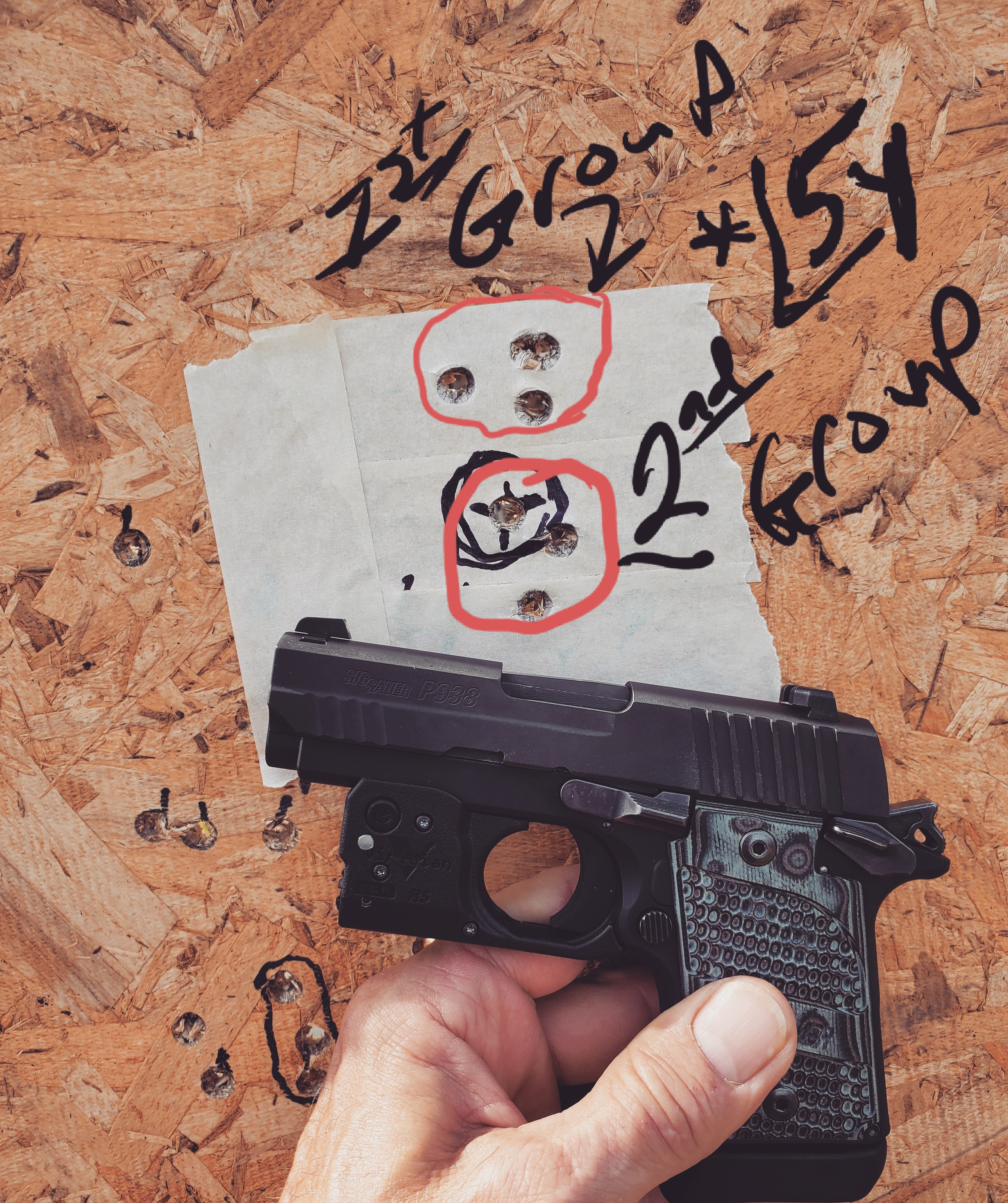

Awesome, Top Quality, Easy, Cheap Trigger Upgrade Kit
Can't beat this kit with a stick! Quick Shipping & Great Customer Service from the MCarbo Brotherhood! *USPS Lost Mine but we Found it) Whether you own a Gen 1or 2? Get this for your SIG P938! I polished just as instructed in the extremely easy to follow video & installed my Gen 1 kit for my 938 Extreme which had an horrendous trigger pull! (8-10lb) she was very gritty & just funky.. She's a smooth crisp trigger pulling shooter now! I don't even need the laser anymore. Just wasted $40 bucks on that. This is a must, the proof is in the pudding!
