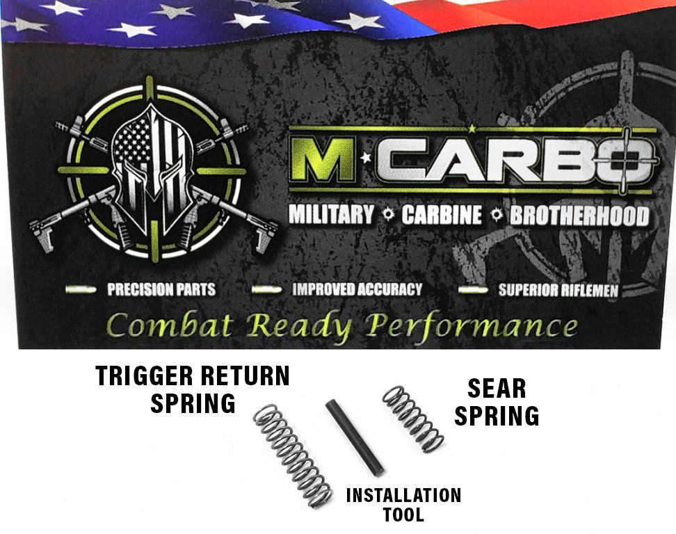

Labeled Ruger 10/22 Trigger Spring Kit - Trigger Return Spring, Sear Spring and Installation Tool

Ruger 10/22 Trigger Spring Kit Enhance your shooting experience with the Ruger 10/22 Trigger Spring Kit by M*CARBO. This kit is a must-have for elevating the performance and accuracy of your Ruger 10/22, making it a notable addition to your upgrade...

My 10/22 is a Davidson's. Polishing wasn't possible because of the different internal materials used. Nonetheless I reduced my Trigger Pull 20%. I like it, and I'm completely satisfied! I called M*CARBO and the large spring is the trigger control spring. The smaller spring is a new sear spring.
