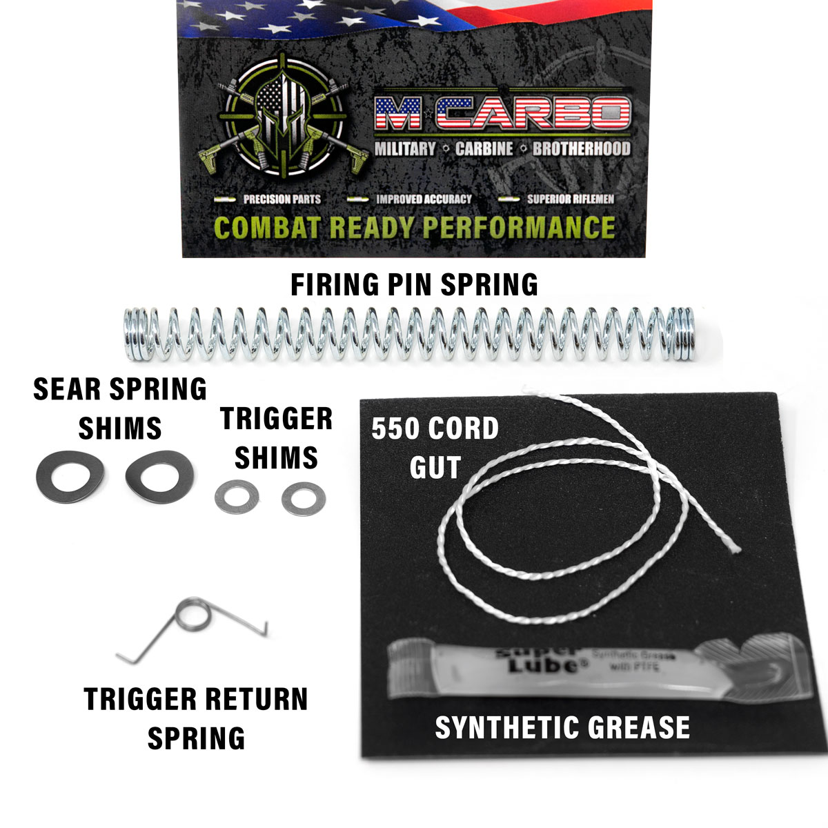

Mosin Nagant 91/30 Trigger Spring Kit One of the Best Mosin Nagant Mods you can make to improve function and reliability; not to mention Reduce the Trigger Pull on your Mosin Nagant Trigger! Most complete Mosin Nagant Trigger Job available by...

kit is for a worn out old mosin to repair he worn / used areas .. BUT on a like / new it is useless as it does nothing or can not fit.. plus the h.d. firing pin spring if it replaces a working one [ shorter / less pressure ] it will increase trigger pressure .. note adjust the firing pin flush as normal then back off 1/2 turn [ down ] and the trigger spring pressure will lessen and be shorter just check the pin extension out of the pin hole in the bolt head .. a heavy spring is for the hard mil-spec. primers and the cold red winters to '' work '' .. a set of lighter pin springs might be a better way for a better trigger pull .as the spring puts pressure on the sear and area you are to smooth out .. so a increase spring is the wrong direction .that way one could try asst. weights till the trigger was as light as they want but still strike the primers well enough with out backing the pin off ..the new trigger return spring keeps slipping off after 5 pulls of the trigger ..

No difference, in fact made trigger heavier
Bought this kit to improve my trigger on my mosin. Followed the video and installed it to find that my 7lb trigger became a 8.5lb trigger.
Took the kit out and did the old fashion file the sear down to achieve a lighter pull.
I gave it two stars instead of one because I kept the firing pin spring which I don't know if it's any better but it's newer and clean so I'll keep it.

I bought this kit after watching the YouTube Tutorial. I am by no means a professional gunsmith, but have no problem following a YouTube video. My only complaint about this kit is the trigger return spring. It would not stay in place on my M91 or M44. I was able to easily install everything and reassemble the rifle. However, after a few dry fires, the trigger return spring would slip off the sear spring. The rifle would still function, but the trigger return spring would not work.
Smoother trigger but heavier
Good kit but didn’t quite work for me with all the parts in the kit. I polished the mating surfaces and installed all the parts. Went from 7.5 lbs to almost 8 lb pull. Yes, increased. I saw someone else had the same issue and put the original firing pin spring back in. Bingo!! 4.75 lb pull. I’ll experiment a little more.
