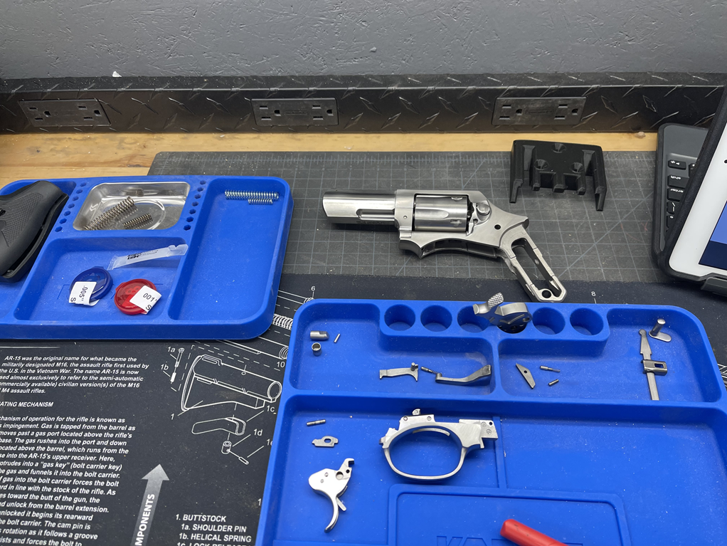

I purchased this kit for an upgrade to my Ruger GP100 revolver. I had long ago installed a reduced power hammer spring which was all that was available years ago. I have purchased 2 other kits, both for Ruger LCP & LC9 from Mcarbo with great success after installation. The end results of this kit produced the advertised percentage of reduction, not always to be the advertised poundage shown on the video where this kit is installed in the SP101. My end results, polishing all internals included are 5-5.5 lbs double action, 2.5 lbs single action pull on the inexpensive Weaver gauge. The action is SO SMOOTH and consistent now, enabling all of my shooting to be faster on sight recovery and targets using only double-action trigger pull. The Video makes it nearly impossible for any installer not familiar with pistol smithing to make an error, from beginning to end! The spring wire material and machining flat on both ends is a huge bonus. No matter how fast you are for disassy. and re-assy.; the polishing will take you some time if done correctly and with care, so prepare to spend about 2-3 hours, depending on the surfaces of your internal components.

I just finished installing this kit, and performing the full detail polishing. As usual, the video is great, and is perfect for maintenance even if you don’t change the parts. I had an issue getting the trigger to pull all the way, it wouldn’t. Lots of trial and error, finally out the factory trigger return spring back in. That resolved that issue. The trigger is much smoother, but both of the spring options included for this were too long and would not allow full trigger pull. The gauge says I’m not getting the proper weight reduction, but it still feels so much better. The shims worked great, and greatly improved fit. I’ll reach out to Customer Support to see if my S/N range is somehow different.

The trigger guard detached much easier than I’ve seen on Youtube. I wrapped cloth around the trigger assembly like you suggested (just in case), pulled the trigger and the pall spring/plunger stayed in place - a nice surprise - then I removed it with tweezers.
Happy to say all the guts were fairly burr-free, but I did the polishing job anyway per your excellent video (no sanding), and installed your trigger and hammer shims.
The hammer dog pivot pin is unusual: it’s a tube, not solid (you can see through it). Maybe this is unique to the original models? It wouldn’t press out with the punch, so I left it and the hammer dog in place until I know more.
Otherwise the project went smoothly, just like your video. Without a gauge, all I can say is the DA pull is vastly improved! Looking forward to the range when it finally reopens (Covid-19).
