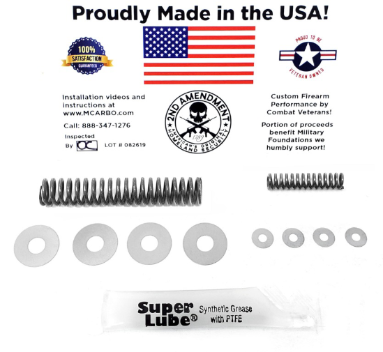

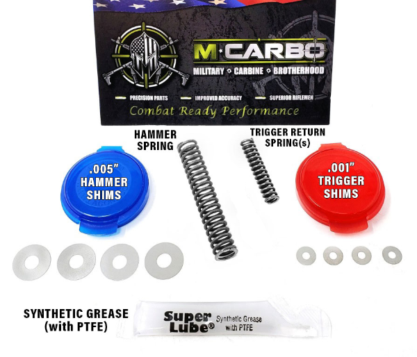

WHAT'S IN THE KIT:
  • 1 - Custom Lighter 9.5lb Hammer Spring
  • 1 - Custom Lighter 7.5lb Trigger Return Spring
  • 4 - .005" Hammer Shims
  • 4 - .001" Trigger Shims
