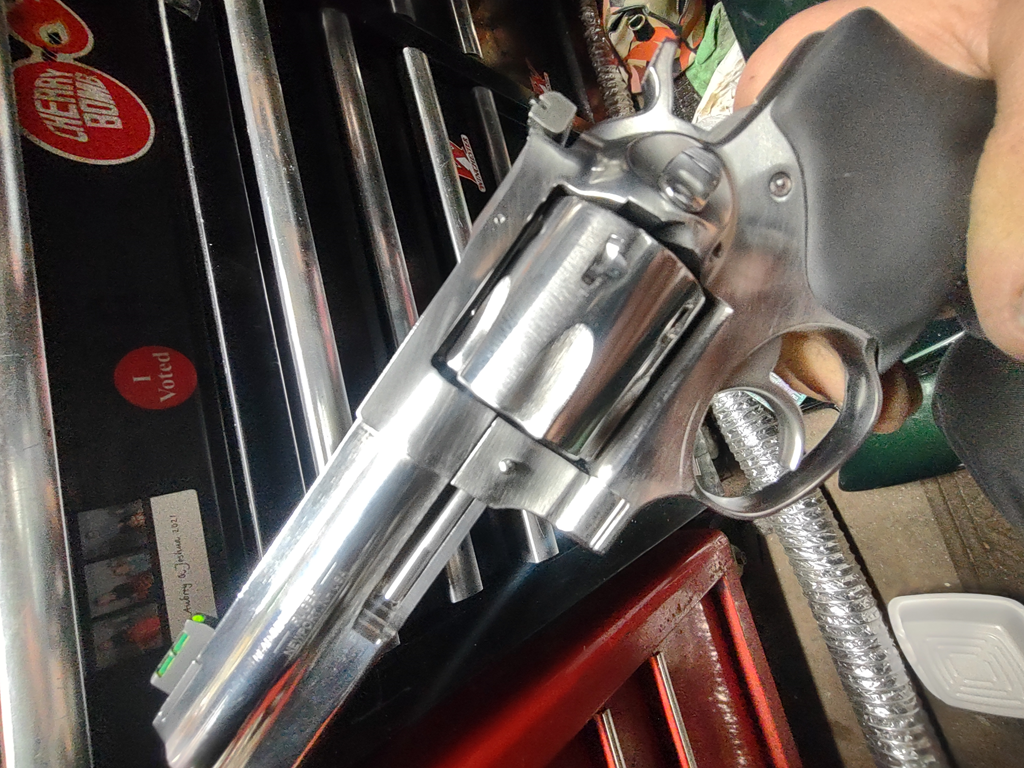

Gp 100 357
This kit made my gp100 feel like the true king of revolvers that it is! install
Was not too hard however i do recommend using a big ziplock bag when pulling trigger plunger springs in and out mine did grow wings but luckily was able to find it .easy to follow step by step and boy what a difference it made . One trip to range so far 150 rounds and no light strikes

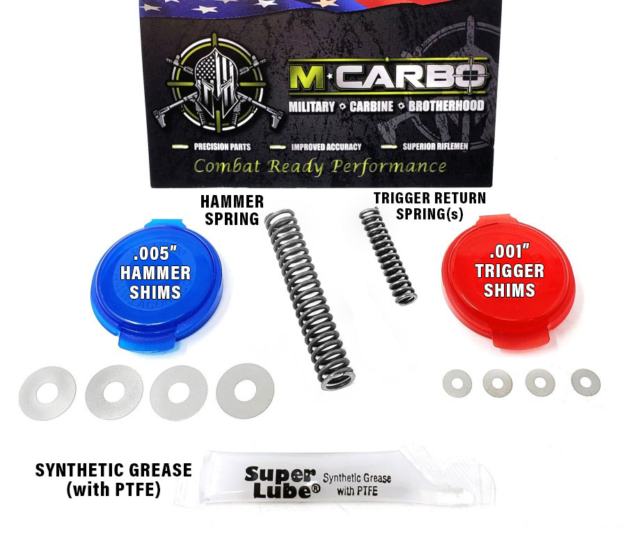

GP 100 trigger spring & shims kit
Parts arrived 3 days after order. Very fast and complete order. After installation and polish job on all internals, trigger was very smooth and crisp. Trigger pull went from DA of 11.5 lbs to 6.5 lbs. SA from 4.5 lbs to 2.2 lbs. Also ordered crowning tool. Looks great and very easy to do. If you have a Ruger, you need this kit. Excellent!

GP 100 Trigger springs
This is a great kit and the shims are perfect. Thanks!
