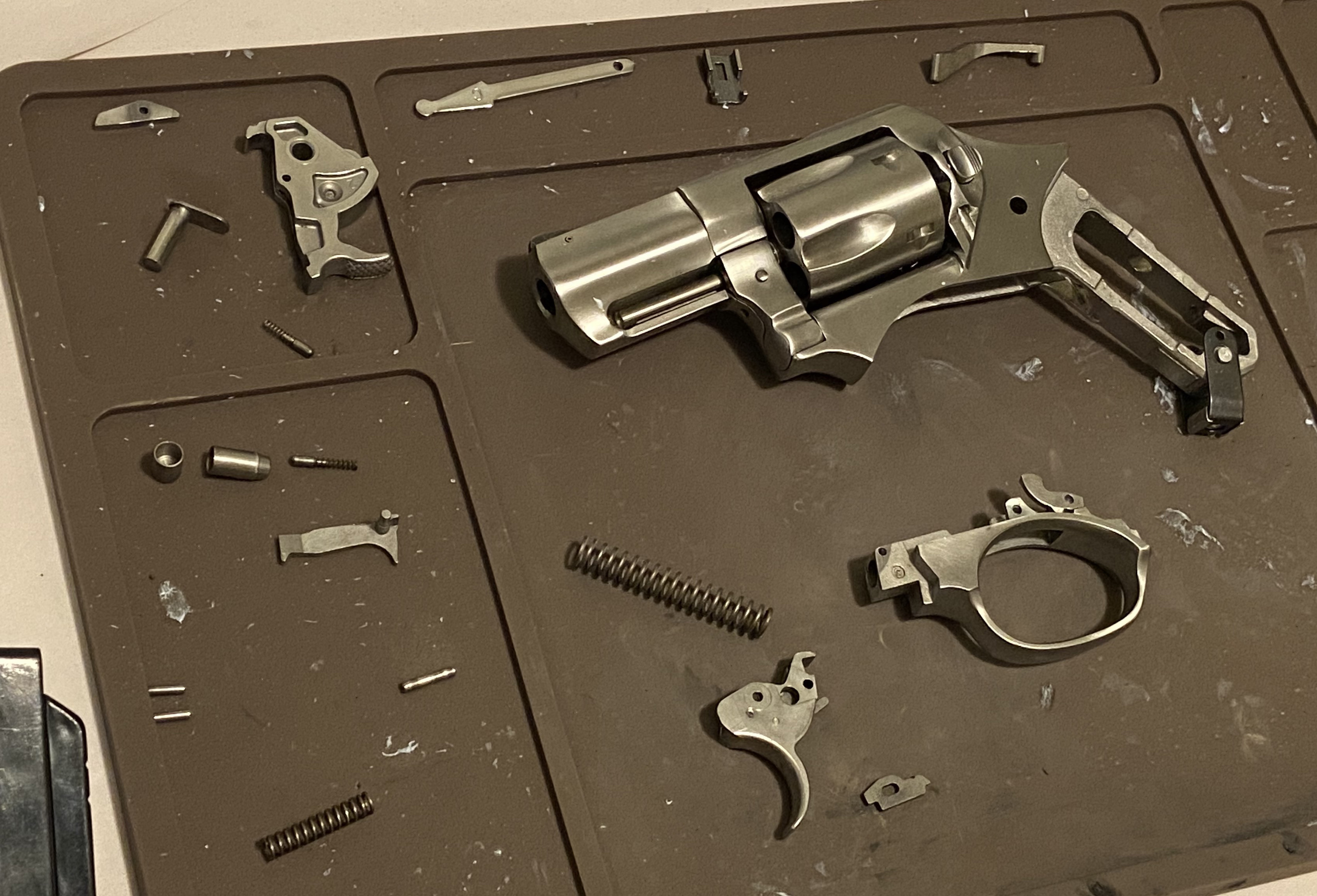

This is the second kit I’ve used
I just finished up my second trigger job using this mcarbo spring and shim kit. The first was an sp101 357mag snub nose, this second one is a gp100 357mag 6” barrel. I’ve done trigger jobs before with springs from other places. But this spring kit with the shims is the only way to go! I did my sp101 a few years ago, and it’s my edc still today. But I’m a little more impressed with job I did on my gp100, unlike the sp101 it had a decent trigger to start with, but it’s even better now! I also polished the whole gun on the gp100. Here’s before and after pics.
