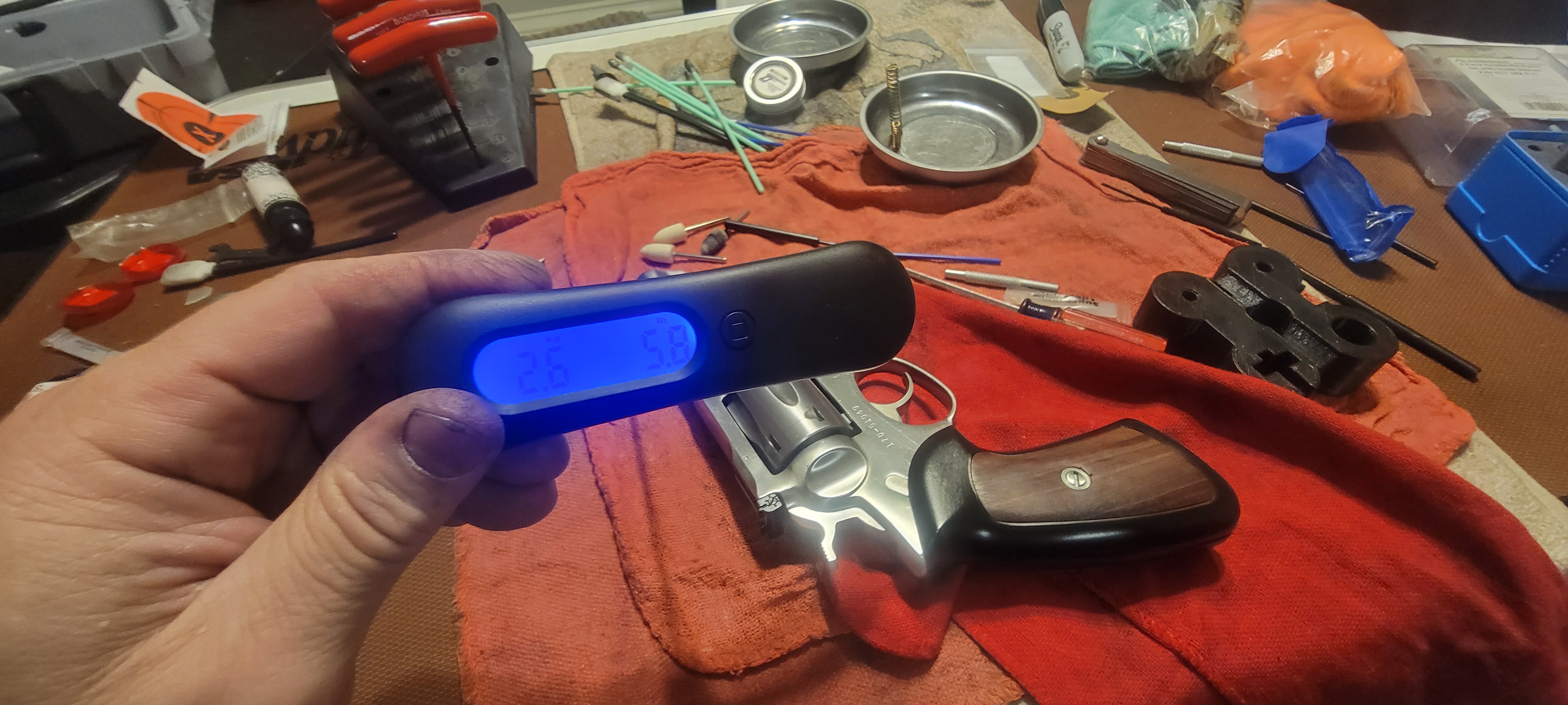

I got a great deal on a 1987 vintage GP100 in 357, and even though it was a great shooter, I wanted to clean up the action and drop the DA pull weight down a bit from its gritty 8.4-pounds.
Having already installed Mcarbo parts in many of my guns, the trigger spring kit was a no-brainer.
The installation was a bit long, since I also did all the action work as in the video -- and I noted there were quite a few small detail differences between my GP100 and the one used as the example revolver.
Still, the parts went in without issue, the rough edges smoothed out, and when it was all done, my DA pull is now a smoooooth 5.8 pounds, and the SA pull dropped to a super crispy 1.8-pound break (from 2.6-pounds before the parts and work).
