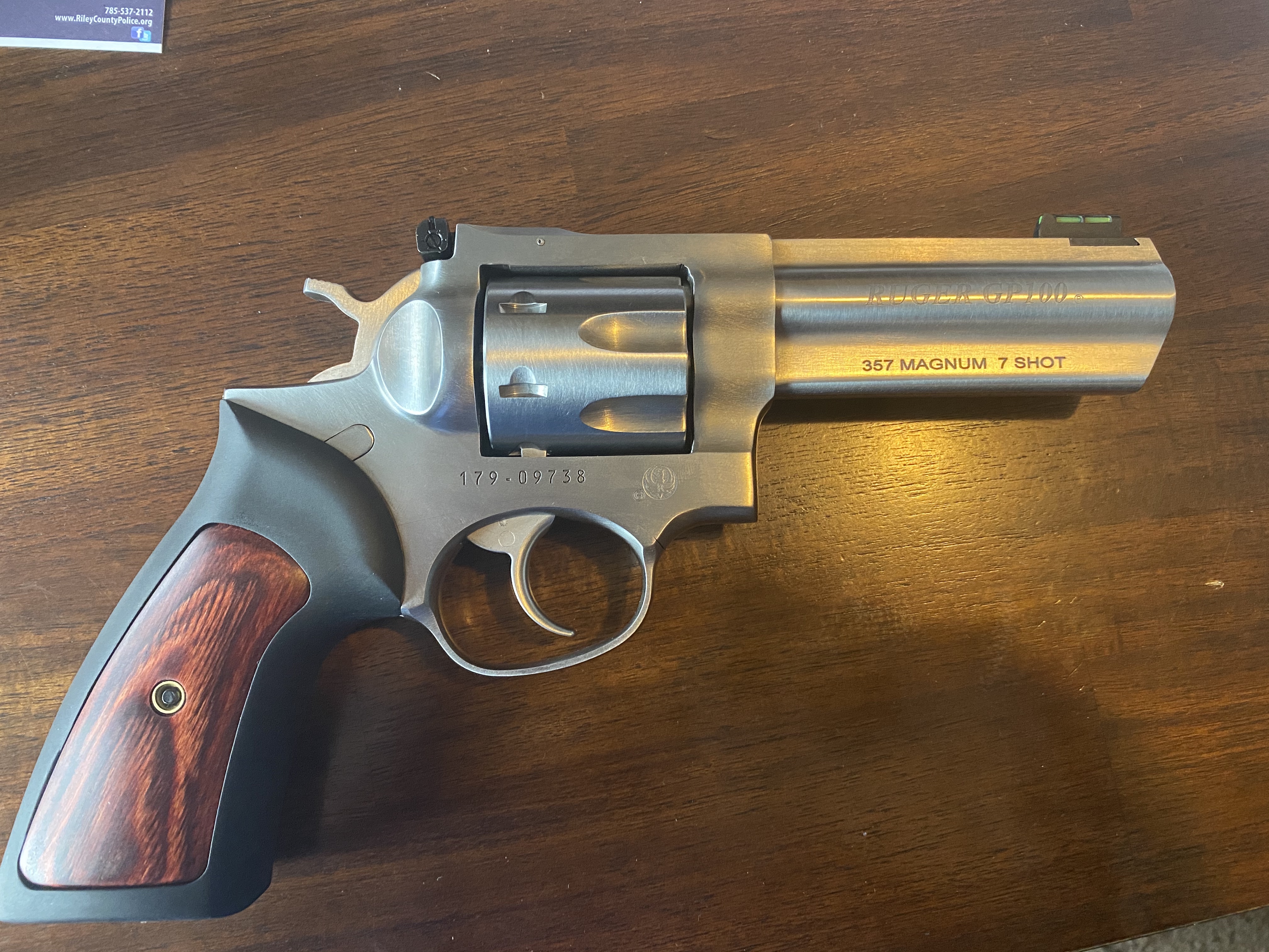

This kit did everything I wanted! My GP100 was pretty good out the box, but now... WOW! I followed the install video, polished the internals, put the new springs and hammer shims in. It's not the same gun. I've done a ton of semi auto trigger jobs, this was my first revolver job, I learned A LOT. I can take this gun apart and put it back together in my sleep. The trigger is silky smooth and sooo much lighter. My POS trigger pull gauge crapped out or I'd give you a number, but trust me you will be very happy with this kit. I was a little worried it'd knock the pull weight down too far, but it's perfect! If you have a Ruger you've gotta get this kit!
If I have one install tip it's, DON'T MIX UP YOUR PAWL SPRING WITH YOUR HAMMER DOG SPRING!!! Save yourself a lot of headache.
