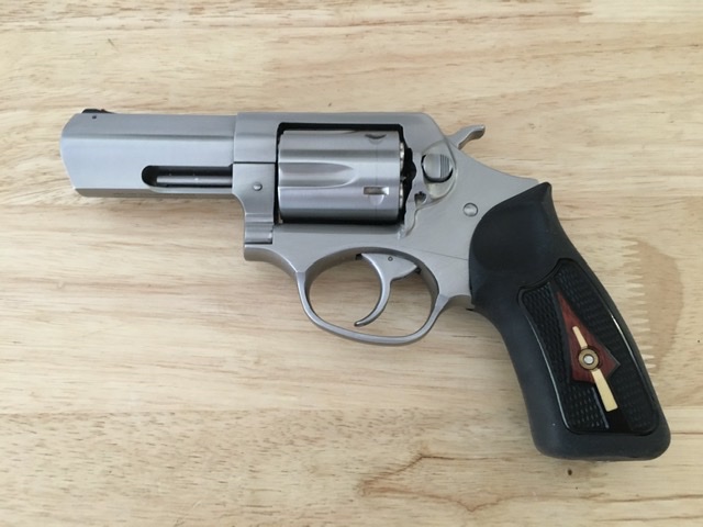

Just finished the spring kit installation and polishing for my SP101 and it made all the difference in the world. The trigger pull is smoother and much lighter. I don't have a trigger pull gauge ,but the SA trigger pull even seems lighter. I watched the video all the way through before I attempted the work. I think the video is the best how-to video I've seen. Think I may do the S&W J Frame next.

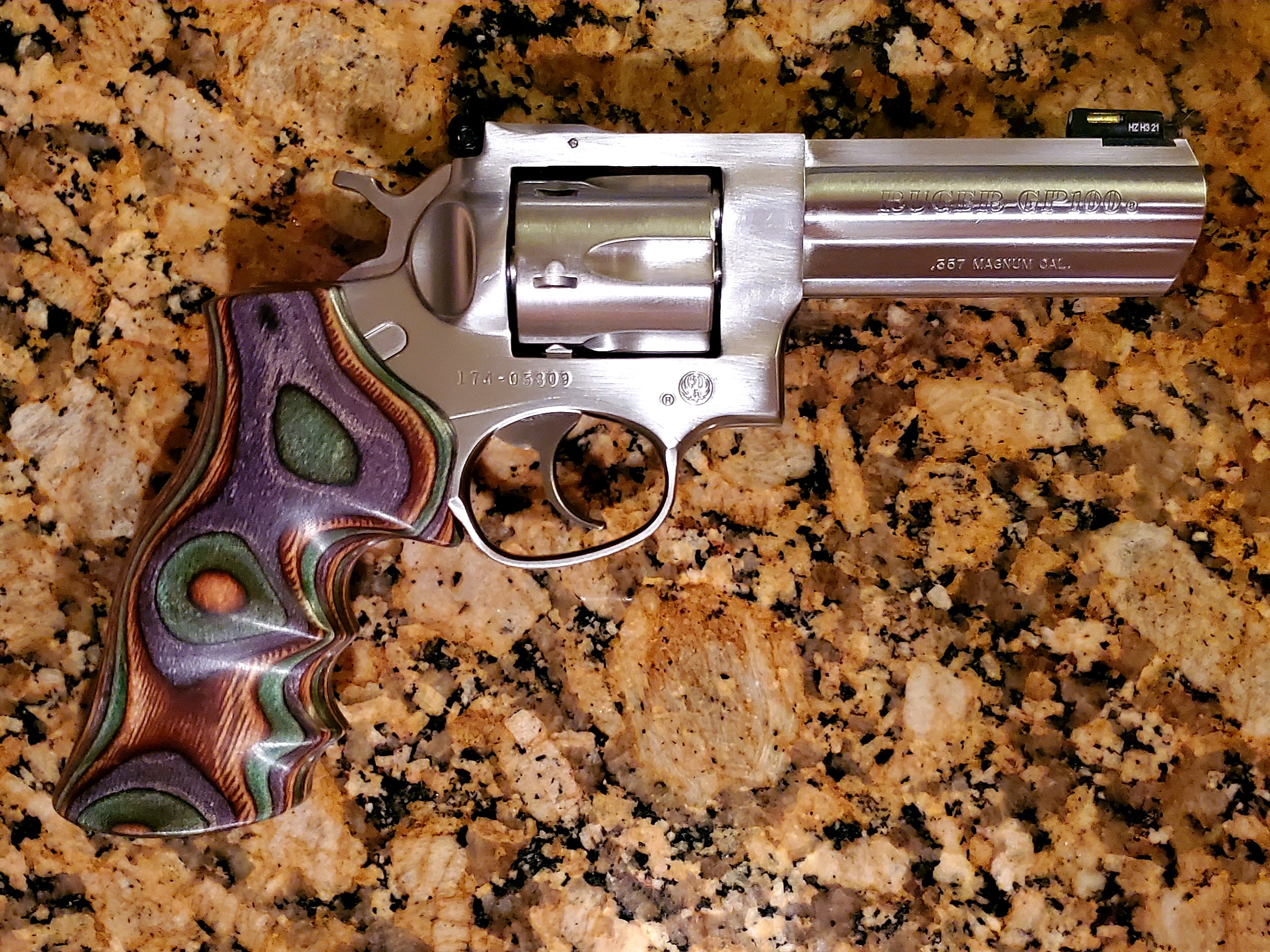

I recently got a Gp100 and the trigger is pretty good out of the box. I wanted it to be a little smoother. So while looking at reviews for the gp100, I came across the MCarbo video on how to replace the kit and polish the insides. So I immediately got in the website and purshaed the spring kit and polish kit. Used the video to do it myself and now the trigger feels like a lot smoother. I'm definitely going to continue with the polishing of the insides. Great high quality product and huge difference in trigger pull.
