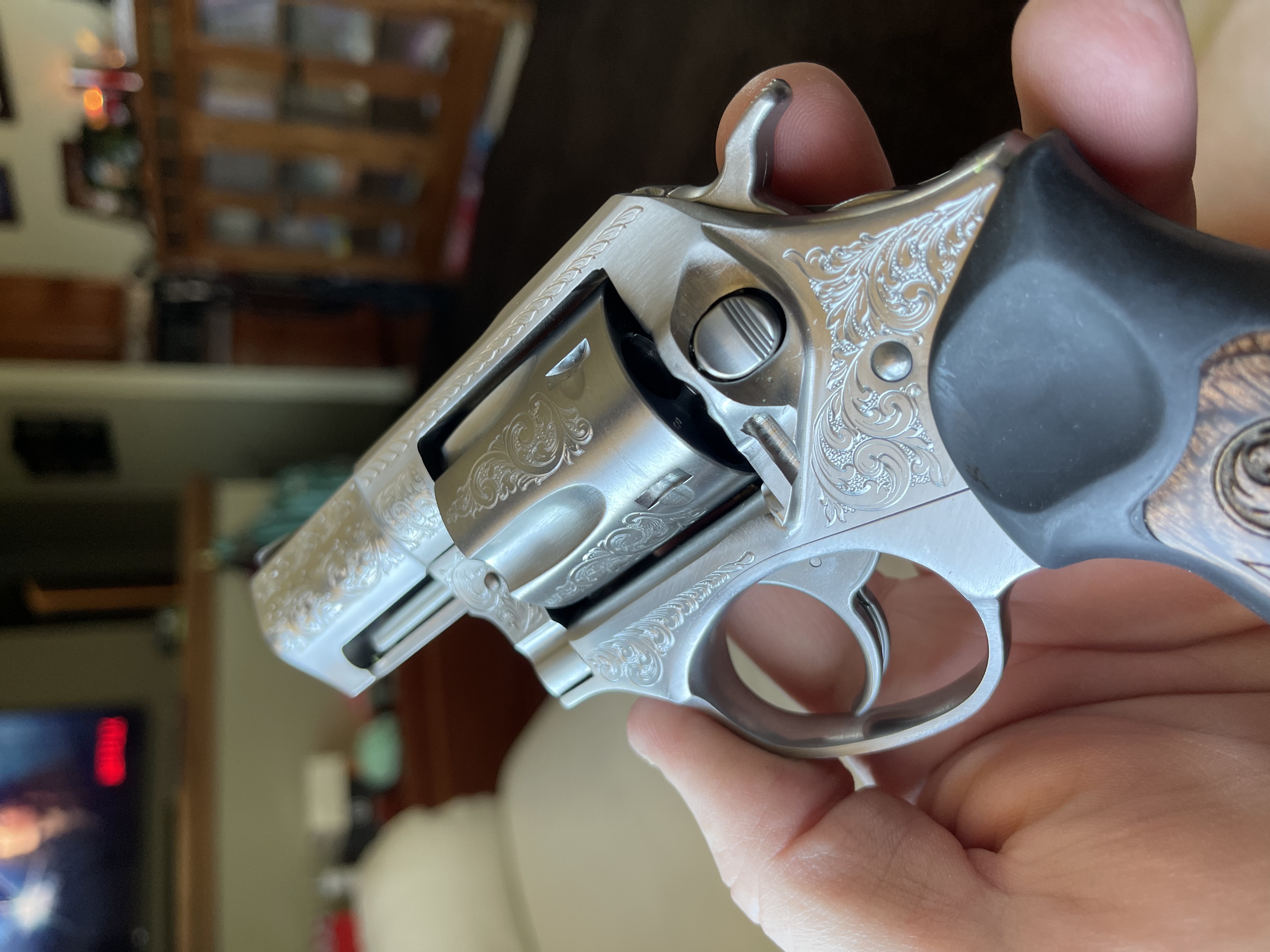

Transformed the action on my Ruger SP101!
