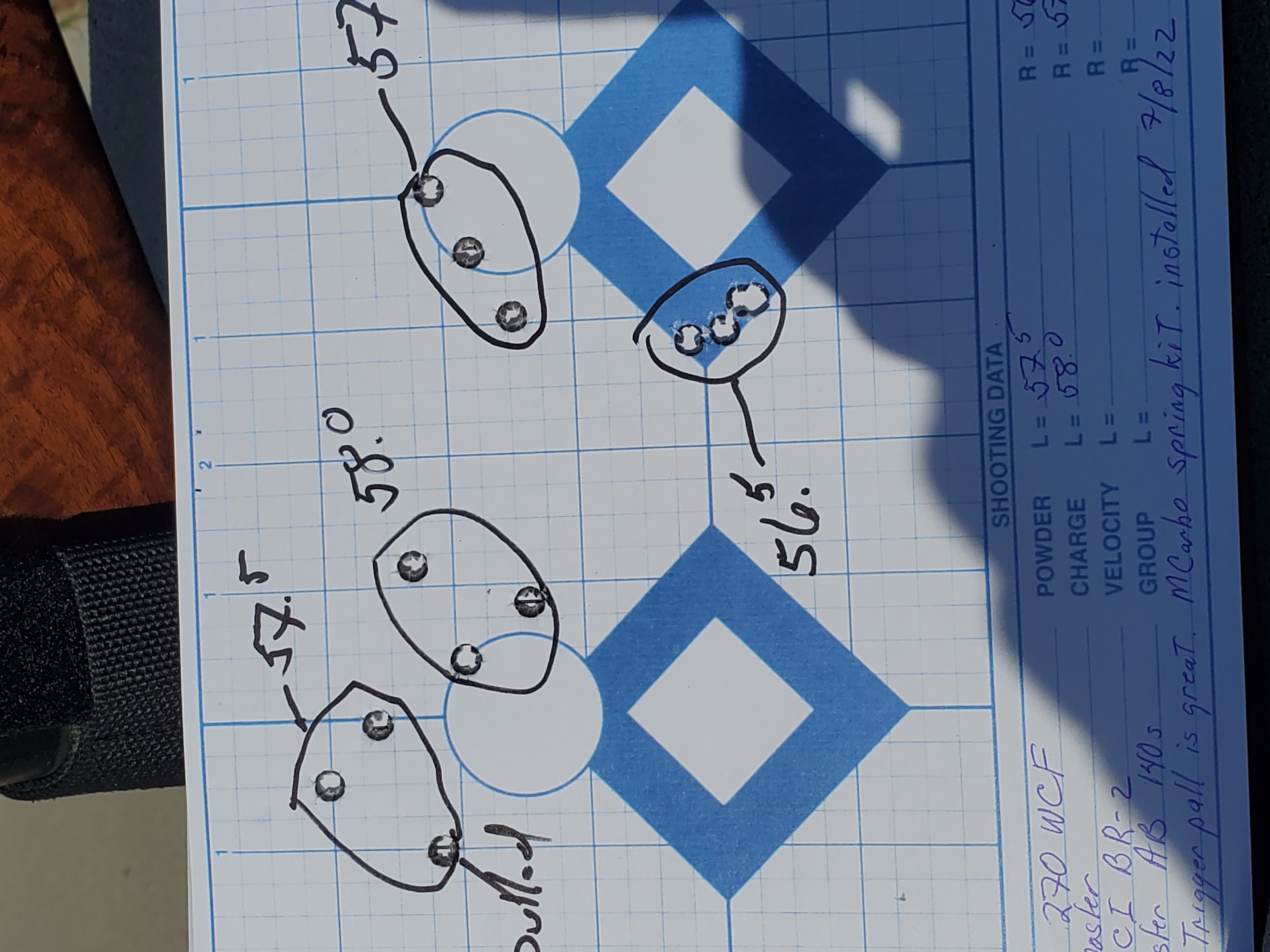

MD 70 FW spring kit
I heard about this sight, from a follow shooter, watched the video, looked up reviews no one had anything bad to say. Shipping was fast, great commination. Spring kit is good quality, videos good. Well done guys thanks. Dropped the pull down to about 2.5 -3 pounds and took up the little creep that was there. Sub MOA @ 56.5 gr.
