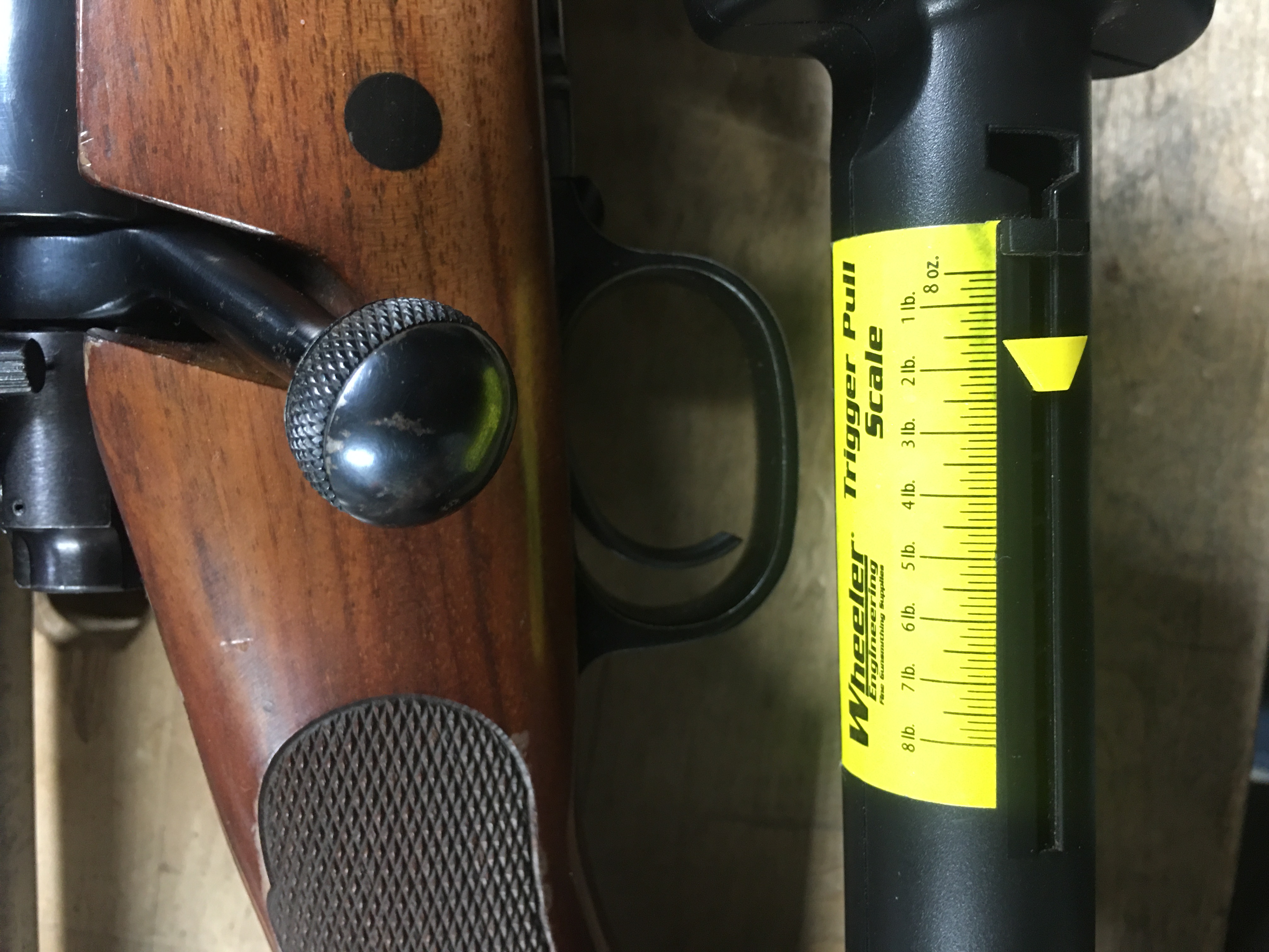

Easy to install and shipped quick . The spring doesnt really do anything to lighten trigger pull . At beginning it was around 5lb 10oz and now is around high 4s low 5lbs . Not a noticeable difference.

Installed spring following video instructions . Easy enough to fallow however Like another reviewer stated I left another nut on the stem . Using a RCBS trigger guage I reduced poundage from 5 lbs to 3 lbs . I like it there for me . On this particular Model 70 Its the XTR model from the 1980s .Supposedly copied after the model 54 Winchester model ? I gave it 4 stars because I haven't shot with it yet . It was good imo to replace the old hard spring an nuts with a softer one . Feels better now .

Easiest trigger job ever! Brought my Model 70 featherweight trigger from a sloppy 4.8lbs to a crisp 2.1 lbs in ten minutes. Just follow the video.

Ordered this spring and installed it per their video. After installing and adjusting the overtravel, have a very crisp 3 lb. trigger pull. Very happy with the results. Great job guys!

This spring was easy to install and delivered a crisp 2 pound setting.

Purchased kit after struggling with trigger pull on Win Model 70 7mm Rem Mag. The trigger was variable from 5 3/4 to 6 1/4 lb needless to say accuracy suffered. Watched the spring kit install on the Tube decided to give it a try. Install was a breeze took all of 20min. After setting trigger travel dropped on the blue locktite tightened the lock nut set overnight and trigger is now 1lb 12oz and is crisp and clean. Super product and highly recommend for the Model 70..

I was please with the price and the speed that the spring was delivered to me. I had checked the original spring at 5-5.5 lbs of pull and wanted about 1.5-2 lbs of pull. The video associated with this product seemed that I could expect something like what I wanted....
I installed the new spring and was pretty disappointed that the pull was at 3.5+ ..... I started using other compression springs I had from other projects and fought it until the pull was about 2.25 lbs. I removed the components (trigger and sear) and used knife sharpening stones and a buffing/Polishing wheel.... with no spring the pull is at 2 lbs. So I used the lightest (but safest) spring I had and settled for 2.25 to 2.5 lbs of pull....

Installation was a breeze with online video. Results are amazing for the price point. Crisp pull with a consistent 1 1/2 lb pull. Absolutely zero creep.

I have used other Win Model 70 trigger aftermarket trigger springs. This one is by far the best. Took the poundage from 4+ pounds down to 1.5 with a very clean break. Very pleased with this product.

Trigger dropped to just under 2 LBS.
tapped butt of gun on the floor and tapped the receiver with a rubber mallet, positive lock up.

Awesome upgrade for my Model 70 XTR. Best thing I ever did was install this spring. Solid easy pull no creep or mushy feel before or after. High quality and great customer service & followup.

Easy to Install and results in a good trigger pull. Just follow the directions on you tube. The trigger will go off if I drop the butt if the stock to the ground above 5". Just be sure you have the Saftey on or nothing in the chamber. - basic gun safety rules!
