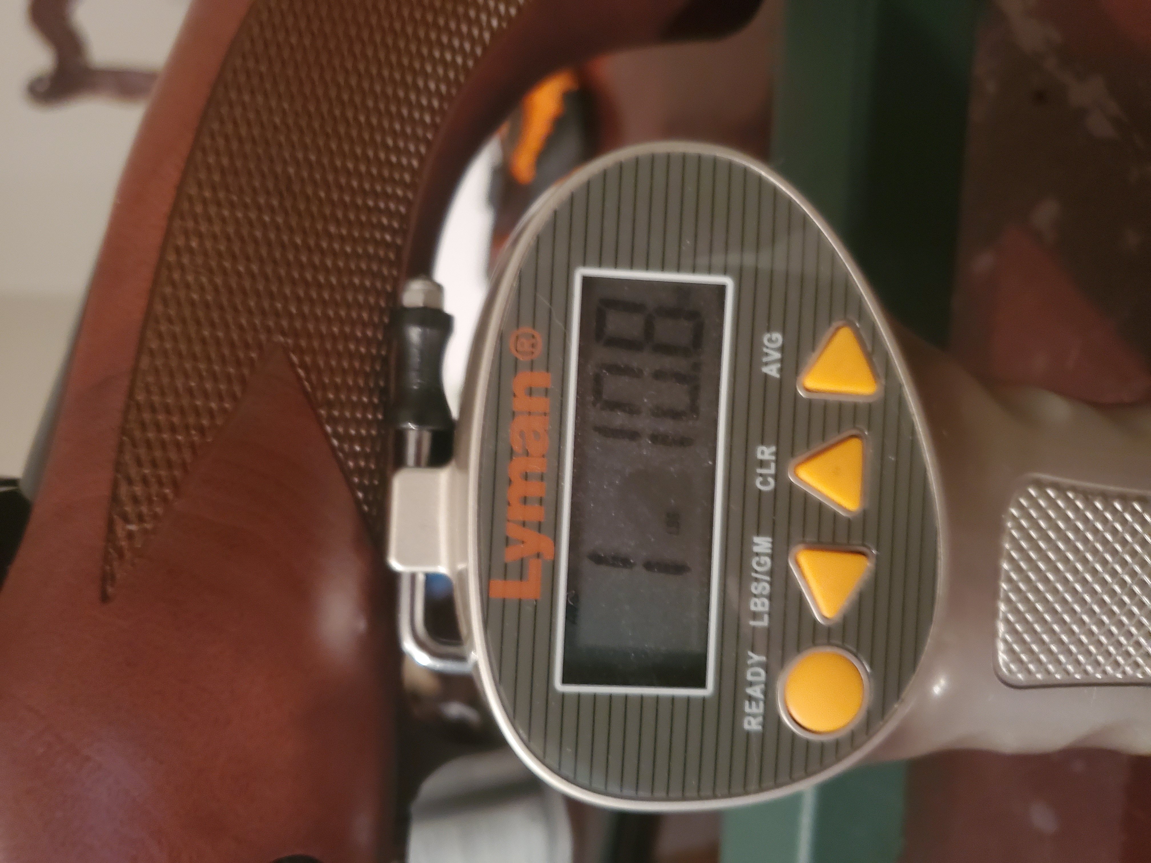

POST 2008 SPRING KIT WINCHESTER M70
I got the kit for my used Winchester Model 70 Supergrade that is post 2008. Trigger started at a little over 3lbs with the adjustment all the way out... but I am a trigger snob (also have very small not so manly hands, and every bit helps me).
***I found that taking the sear actuator out is not needed... once everything else is out the actuator will flop out of the way to replace the small spring... saving the risk of more small parts to lose, bend, or brake***.
***definitely have a friend help with last step of putting everything back together***
Final trigger weight is 1lb 10.8oz

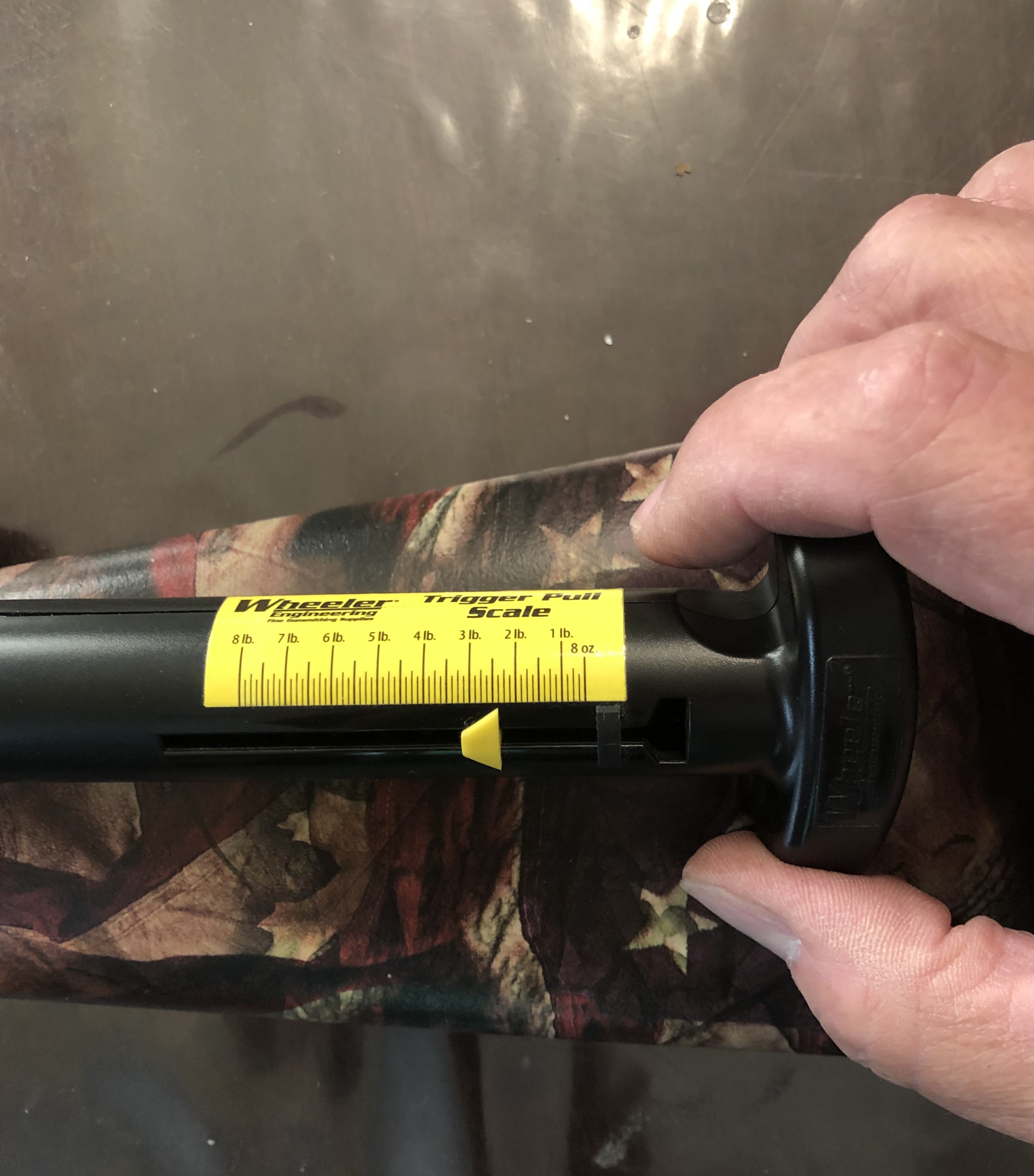

post 2008 spring replacement for model 70
Stock trigger pull consistently came in over 5lb. I followed the video instructions (not as easy as it is made to look, but anyone who can follow instructions can do this, no gunsmithing genius required. My results, a consistent 2lb 5 1/2oz, give or take, with occasional pulls under 2lb. The difference between a usable field gun and one that isn't!

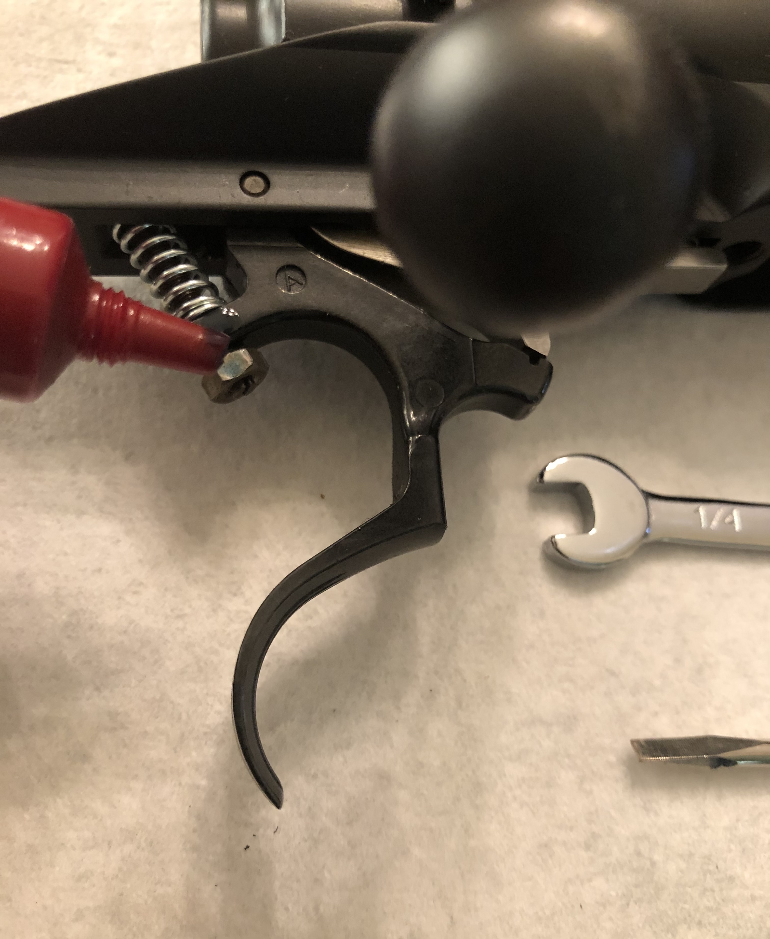

Savage axis pro kit
Very easy to install with a large thanks to the instructional video. Made a world of difference in how sloppy and hard the trigger was.
