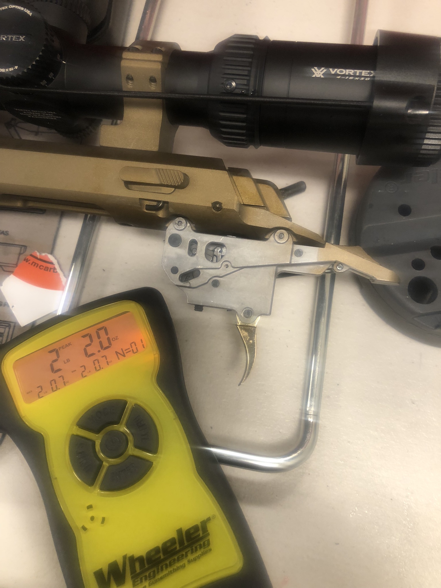

The new spring is awesome. The trigger is now very crisp and light. An average of 5 measurements just taken on my Wheeler gauge
is 1 lb 13 ozs.!! Factory was average 4 lbs 3 ozs.
