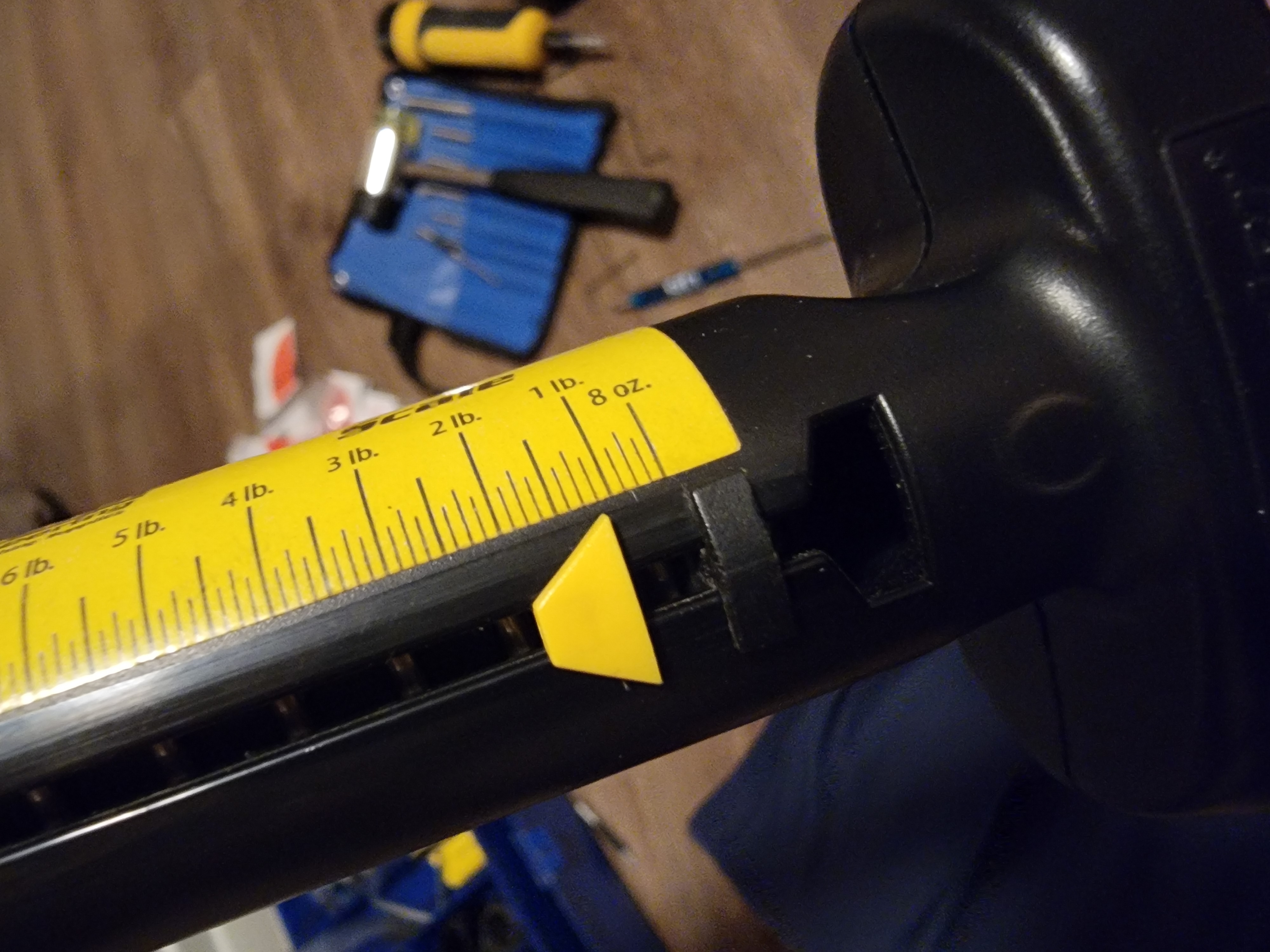

I used this spring to reduce the trigger tension on my X-Bolt Hell's Canyon 300 WinMag and it worked as promised. My trigger tension dropped from over 4.5lbs to 2.4lbs which is where I wanted it. I could have reduced it further by about another 1lb. but preferred this trigger weight. I also appreciated the video that was used to show how to get that stock trigger out of the rifle. M*Carbo does it right!!

I have the an xbolt eclipse target and didn't wanna spend the money on a trigger so I figured I would try this first. I was getting a trigger pulled of 2 ³/4 pounds before. Put this spring in yesterday and now I'm getting a trigger pull of 1 ¹/8 pounds.

Relatively easy to install and took exactly one pound off the trigger pull. Consistent break at 1 lb 13 ounces.

The only problem I had with my Browning X Bolt was the trigger. It was almost 5 lbs. with the adjustment screw almost all the way out. The MCarbo trigger spring took that down to 2 lbs. 14 oz. It takes a little patience to get the factory spring out but once that is done the rest of the install is a breeze. If you have a X bolt buy this spring kit. You won't regret it.

Changed the factory setting from 4.5 lbs to 2.75. Made all the difference in the world. Super easy to do also.

Spring worked great--I was able to set trigger pull at 2 3/4 pounds versus the almost 6 pounds on the factory trigger. I highly recommend watching both installation videos. Removing the factory spring takes a little time and patience but it is worth it.
