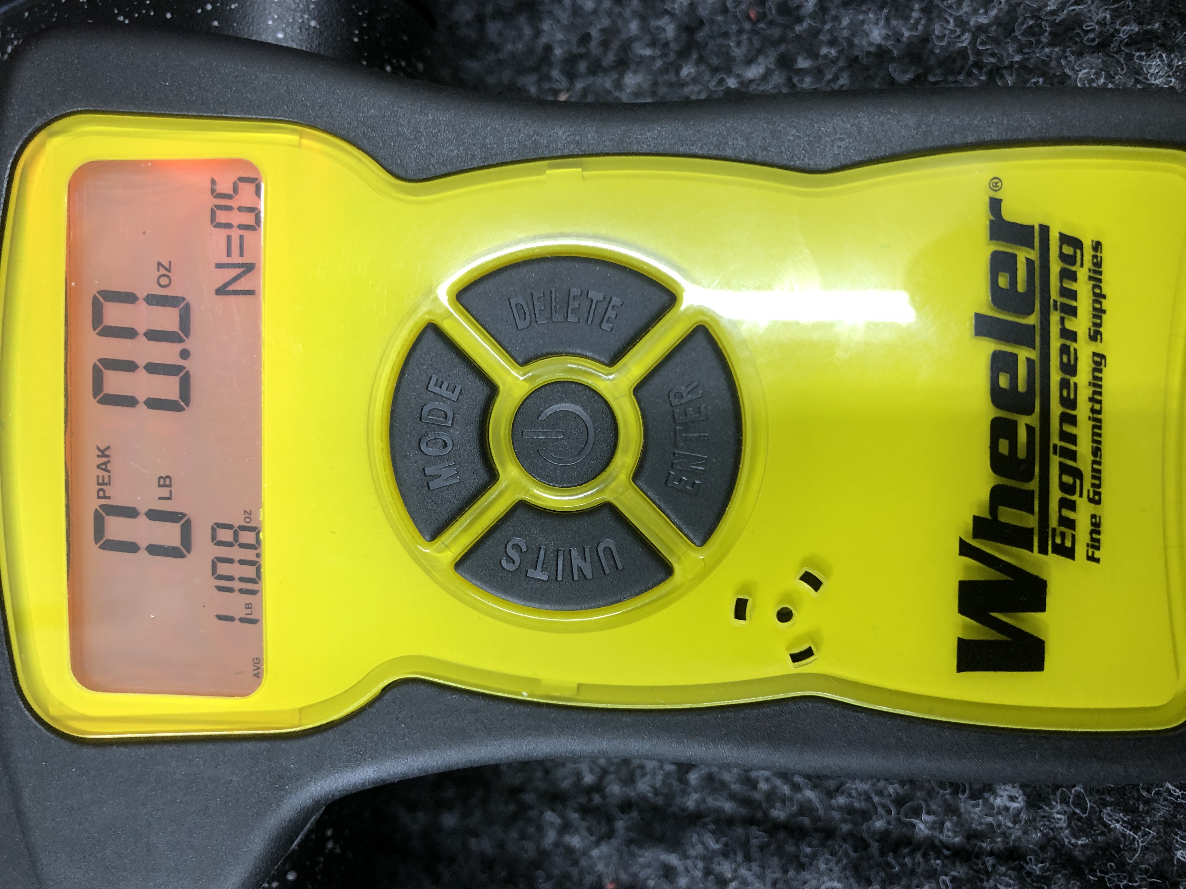

I ordered a M*Carbo trigger spring for my Browning X Bolt Max Long Range. Fast shipping. Very easy installation. Trigger weight before install (3lb. 13.2 oz.). After install (1lb. 10.8 oz.). Very impressed with this company. Great product.
