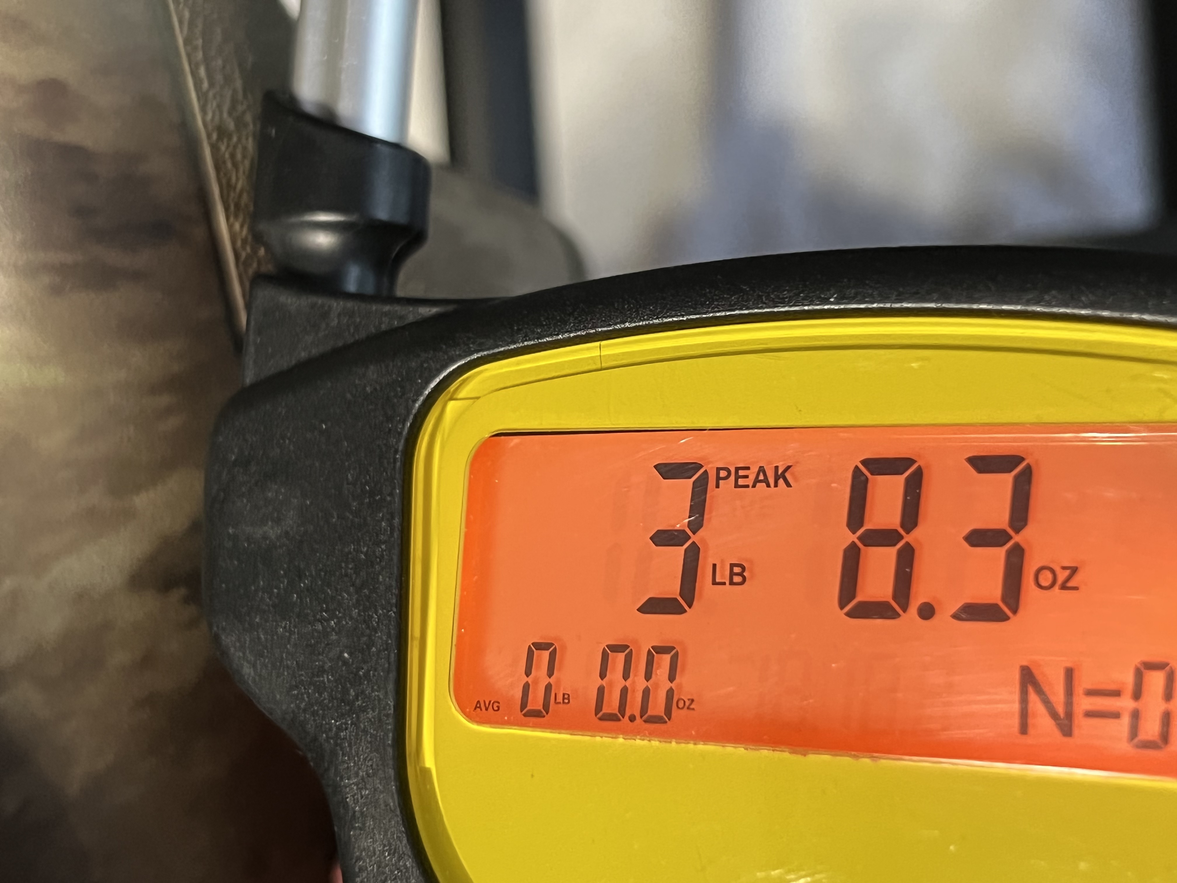

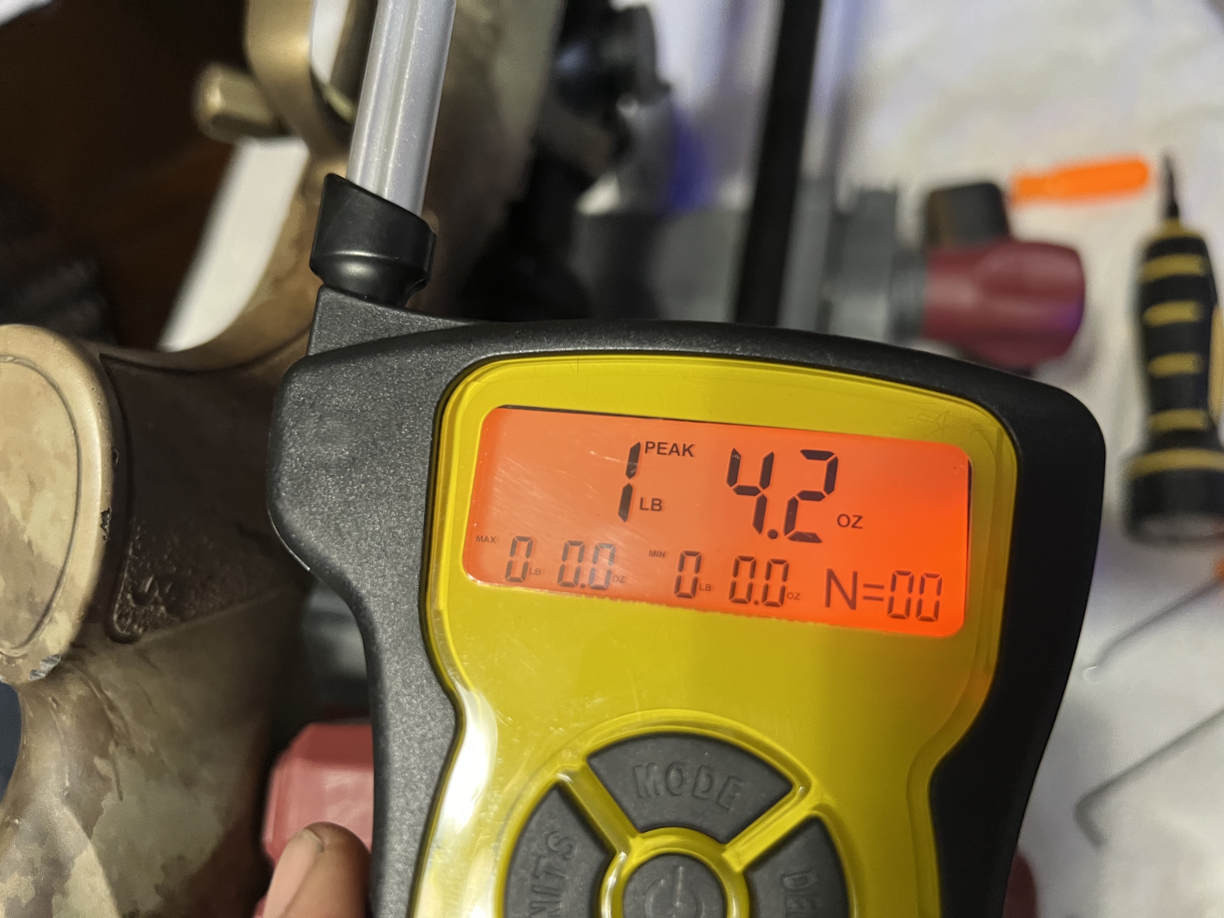

Saved me a lot of money!
I talked this and my trigger went from 3.8 to 1.4lbs, was gonna order a drop in trigger and this kit saved me some $$$
