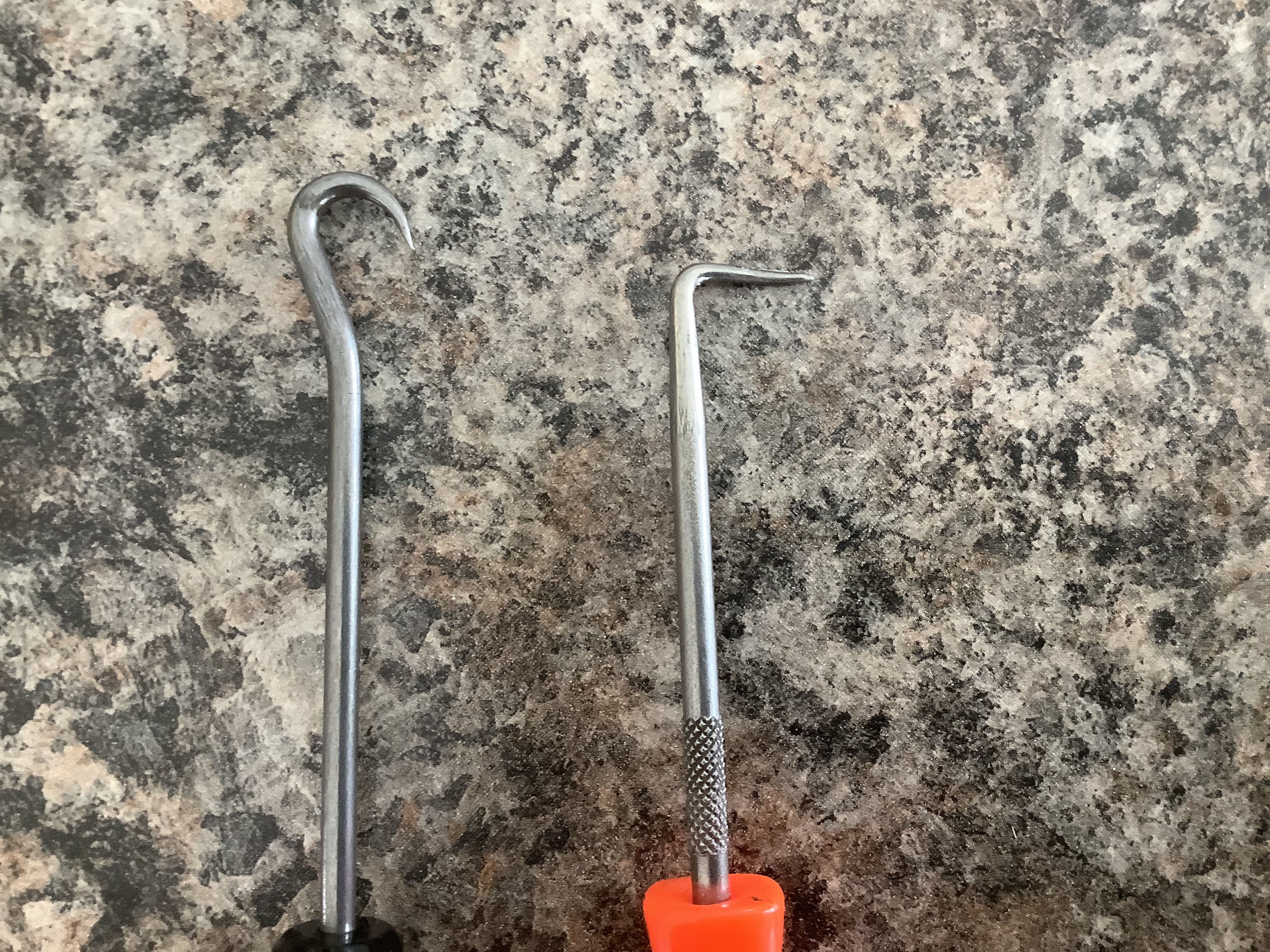

Making my Browning XBOLT TRIGGER SWEETER
From what I’ve see and heard about the Browning X bolt trigger titled Feather trigger not living up to it’s name. And I’m sure you all have seen the comments on YouTube etc. Just replace the factory spring or could say lawyer spring ? With a Mcarbo trigger spring. My Browning 300 win mag target varmit model style stock came in at 3.75 lbs in adjusting the factory spring got it to 3.5 lbs. Installed the Mcarbo spring I am a consistent 2.5lbs with the recommended leaving 2 visible screw angles showing. It’s awesome ! So guys get the Mcarbo spring and if you have patience and the right tool to get the stock spring out which I have a pic of. And have a little savvyness you can remove that factory spring. And wat is really awesome is the new Mcarbo spring just needs to be dropped down in set screw hole. Have blue loc time to secure things. Thanks Lefty
