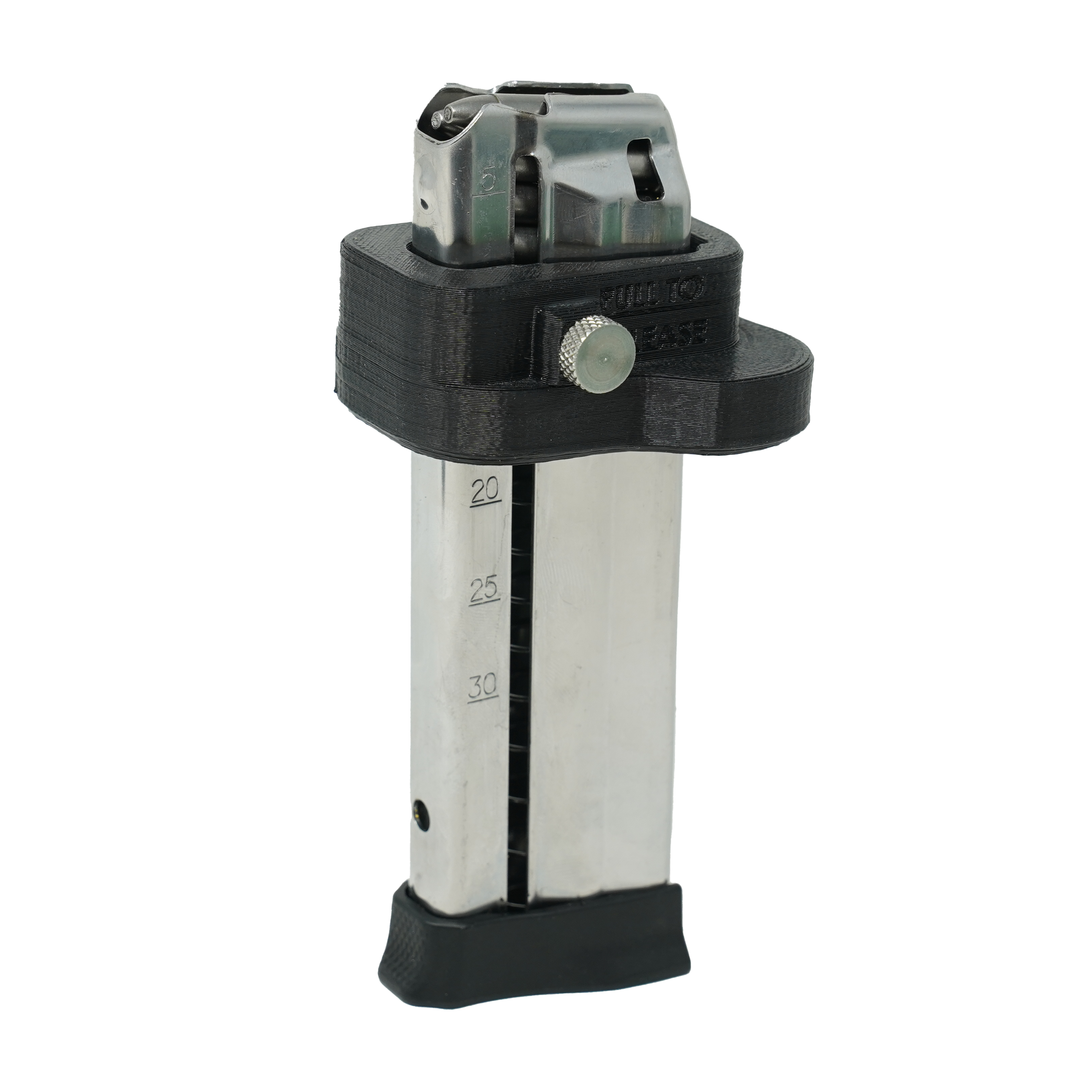

Way better loading than OEM, the speed loader really helps loading and consistency. Tried it with my PMR30, started with 10 rounds, then 15, 20 and 30 rounds. Spring comes in slightly stiff but it not an issue with the speed loader, probably helps with the feeding. Magazine is also super polished, feels pretty much like a mirror. Overall a good magazine

So, I like this magazine. Definitely an improvement over the original, however it did not fix my feed problems completely - improved yes. I have determined the feed problems are a reflection of how the magazine itself is loaded as these 22 mag rounds can get a little "out of stack" in the magazine causing a feed problem. Now that I know what to look for, this magazine comes with the side slots (windows) and allows you to see if you have loaded the magazine correctly, and where a problem is going to occur. To correct the feed stack the new speed loader allows you to manipulate the spring and ammo stack in the magazine to correct it. You could not do this with the old mag, you were pretty much at the mercy of the magazine and would have to unload the mag one round at a time to find where your stack had bunched up. What I have described works, not perfect but a lot less mis-feeds. I chucked the old mags and the MCarbo speed loader after I discovered this. Just so you know MCarbo upgraded my P30 with all improved parts before I tried these new mags.

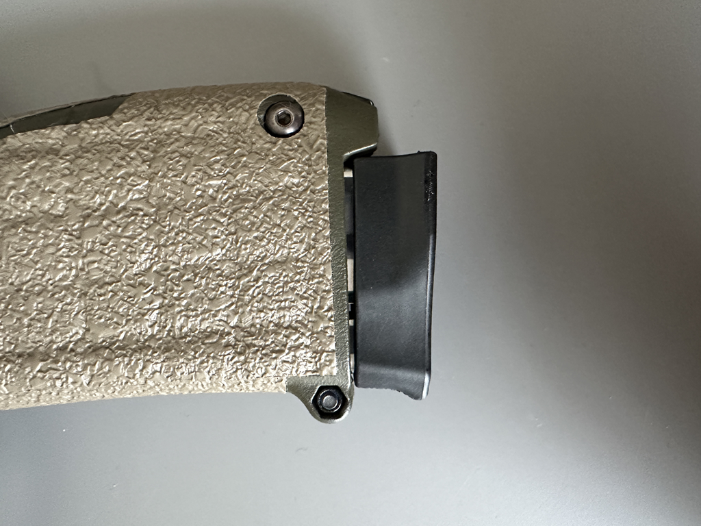

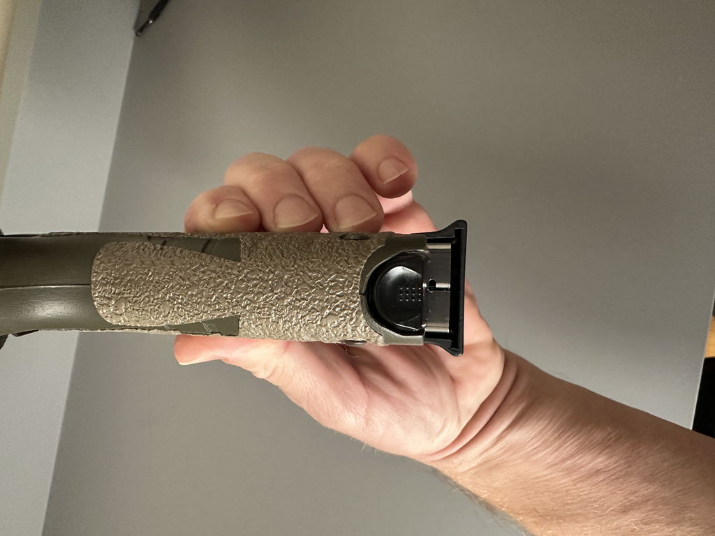

First impression, it's a thick gauge of steel, not cheap and thin.
The baseplate is 5/8" thick. 3/8" of that hangs below the lowest point of the of the grip @ the mag release. For only +1 capacity, losing the flush fit by this much doesn't make sense to me.

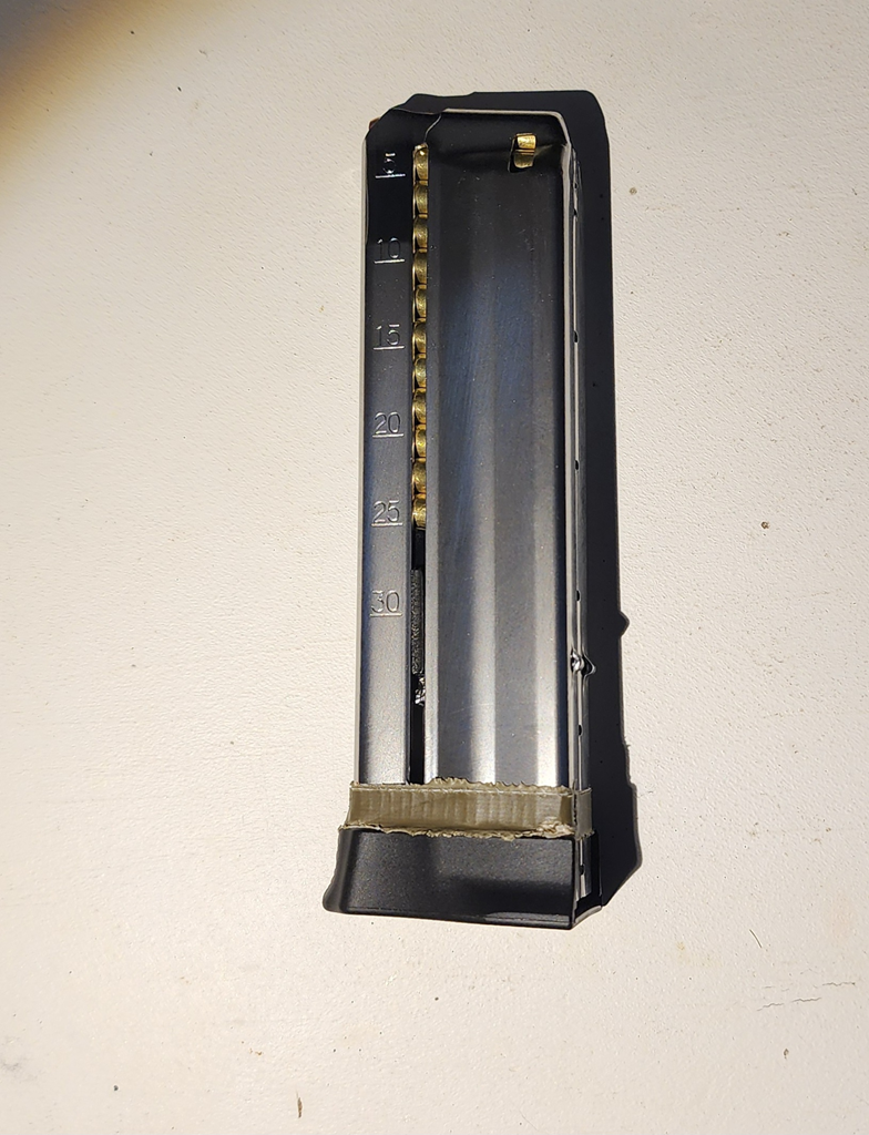

So my mag did have a little wiggle however was quite secure. So super easy fix
100 mph tape for the win.
