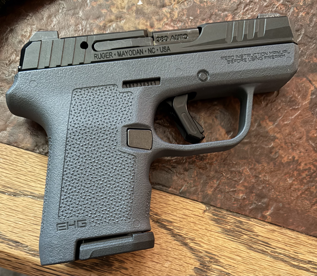

MAGPUL EHG LCP MAX
I installed every MCarbo upgrade in my new LCP Max Magpul Edition in about 30 mins. Haven’t shot it yet but I did the same to the previous version and it worked flawlessly. My favorite parts are the aluminum trigger and the power recoil spring. Feel better look better. Just wanted to verify everything works with the Magpul edition.
