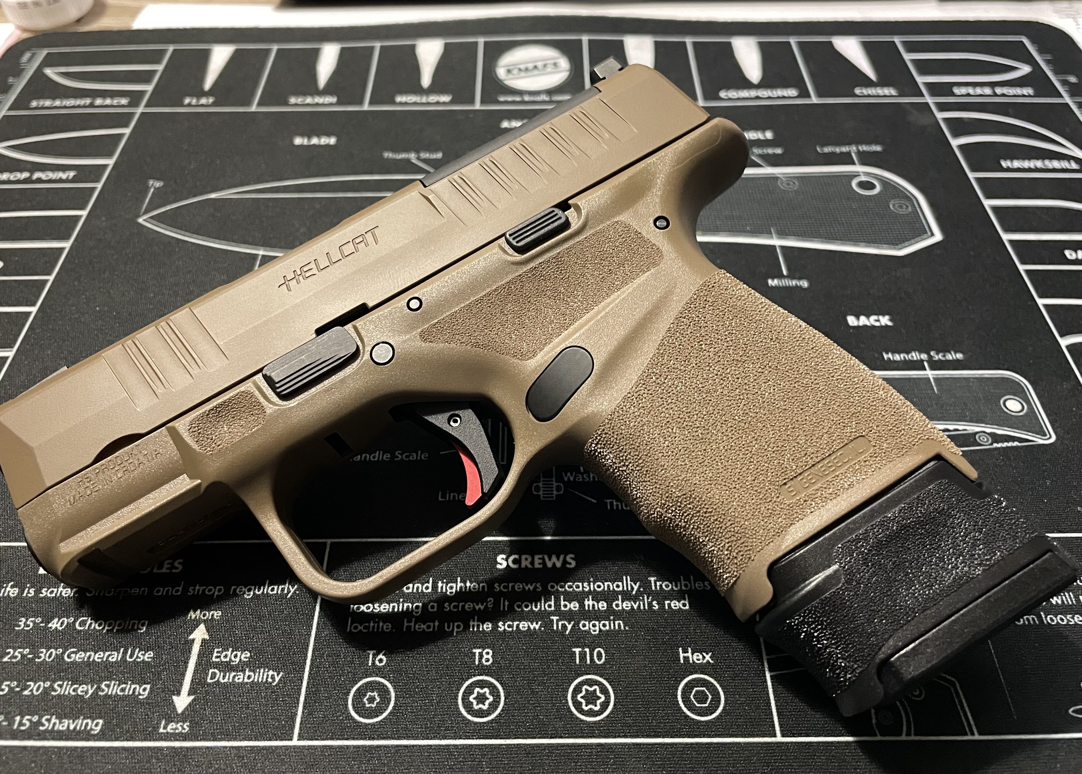

Worth the cost. Improved trigger pull from 5.5lbs to 4lbs. Action is much smoother than the OEM trigger and springs. I also followed Chris's recommendation on polishing and then polished some more. I actually polished inside the firing pin housing as both the stock sleeve and new stainless sleeve seemed gritty and draggy. I also polished both sides of the sear. Seemed to make a difference in how smooth the trigger felt.

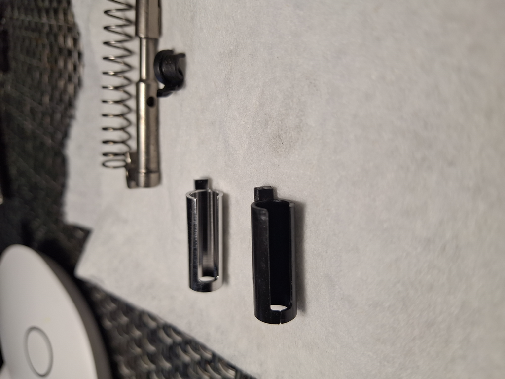

I originally bought this kit with the sole intent of only using the striker sleeve. The sleeve is of amazing quality, and disappointed that Springfield would omit something like this from the Hellcat. To be perfectly honest I am still on the fence regarding the included springs. I installed the two replacement springs to feel the difference, and was slightly disappointed I did not notice more of a reduction in trigger pull as shown in their video. Installation was a breeze with any level of firearm disassembly experience. I would definitely recommend just on the striker sleeve alone, and leave it to the discretion of the end user on the usefulness of the included springs.

First off I work on firearms but this is very easy and the video is very helpful. My Factory set trigger was just over 6lbs after the installation I was just under 4lbs great product ! I'm very happy thanks for catching the plastic striker sleeve. Also thanks for the fast service M CARBO.

Got this in the mail yesterday along with a new trigger and other upgrades. I was very disappointed in the plastic sleeve that came in the striker and was very pleased to see the replacement. Nice strong material and the springs are solid. Side by side you can tell a difference. I was extra pleased with the takedown and installation video that shows every single part and component in great detail. Clean and straight to the point, no extra fluff. Nicely done. And also as an army veteran myself, I will definitely purchase and support this organization.

I purchased my Hellcat a year ago and it had the worse trigger pull I ever experienced. It was 8.2 lbs, gritty, with a bad reset. Bought it for concealed carry. Put 500 rounds thru it and wasn't confident in its performance. Bought the Mcarbo trigger spring kit. Installation was quick and effortless as I had my laptop in front of me and followed the step by step tutorial/ installation instructions. Looked intimidating at first but really wasn't. (And yes the striker sleeve was cracked). Easily replaced OEM parts with Mcarbo parts (you could definitely see the difference in quality) and polished recommended components. Trigger pull was reduced to a crisp 3.9 lbs., smooth as silk, with a crisp audible reset. Now I enjoy shooting my Hellcat and confident enough in its performance to use it as my primary carry gun.
