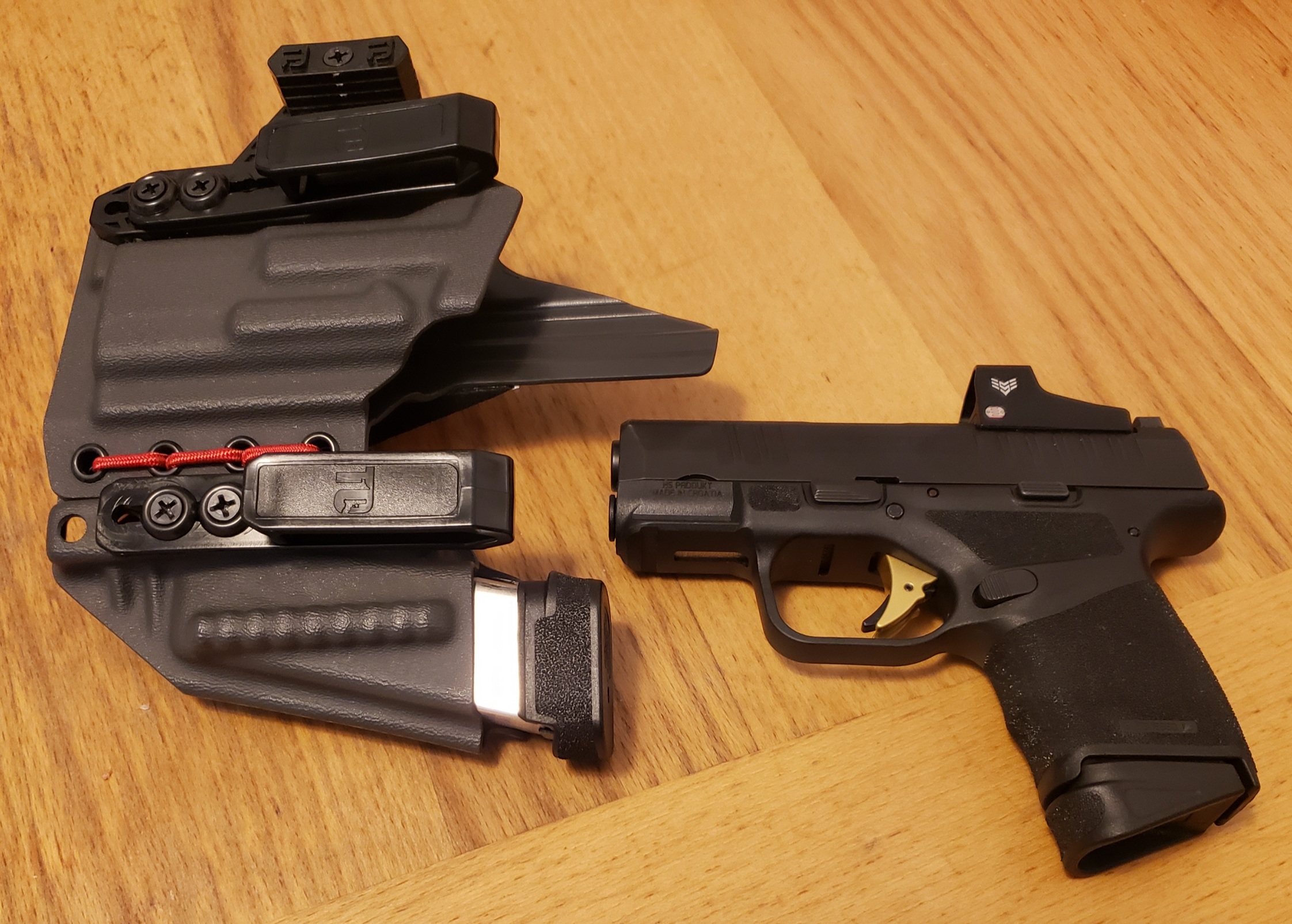

Prior to installing this spring kit and stainless steel striker sleeve I had already upgraded my Hellcat trigger to the Hyve Monarch; mainly to reduce the pre-travel. On my pistol this increased the trigger pull force by about 8 ounces over the OEM trigger's, to 6 lb, 12 oz.
With the M-Carbo springs installed the trigger pull dropped to 4 lb 10 oz. I also polished the internal surfaces suggested in M-Carbo's installation video. I really love the results with both the Hyve trigger and the M-Carbo springs.
Installation was easy after watching the instructional video. Thanks to M-Carbo for a good product and great customer support.
