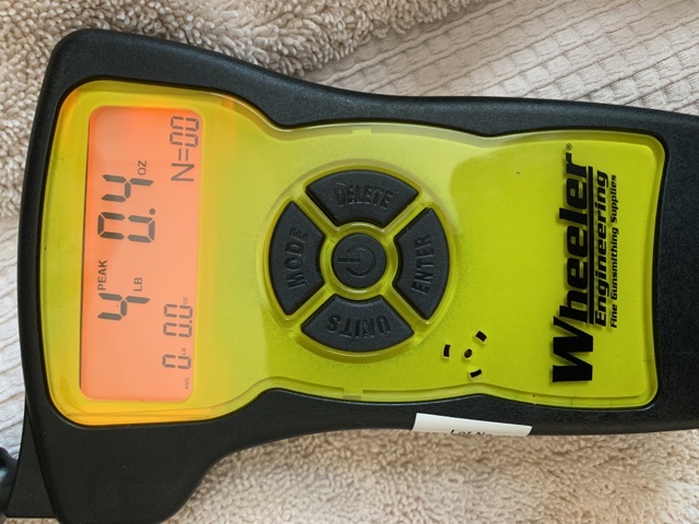

M-4 trigger spring
I received the MCARBO replacement spring for my Colt M+4 yesterday, installation took about 15 minutes and working with the MCARBO utube video playing made the install seem smooth and effortless.
The proof of how well the spring works is in the attached photo of the after install reading on my Wheeler digital trigger pull gauge. Before the install, the reading with the factory trigger spring was 6.13.3.
Thanks MCARBO!
