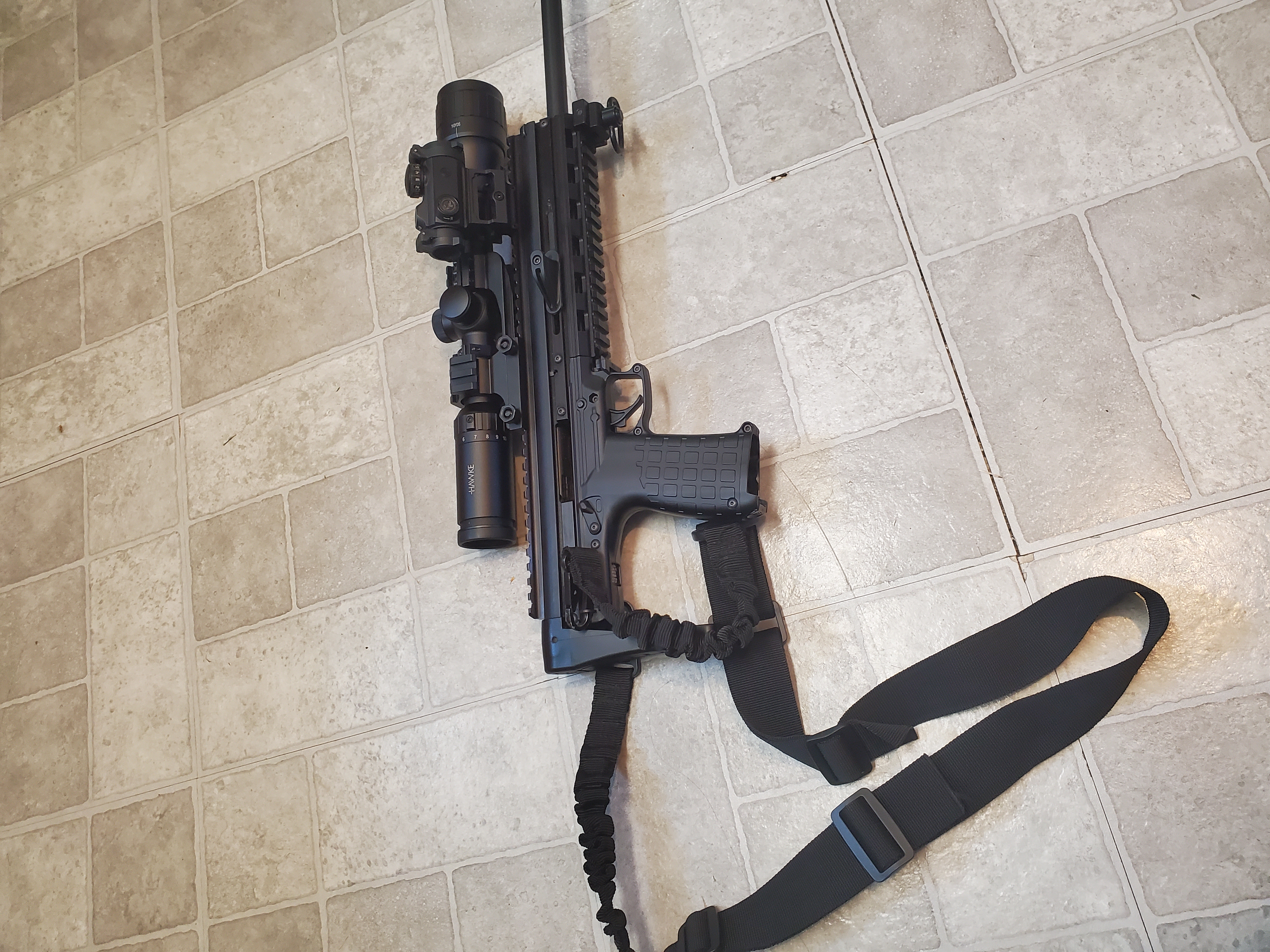

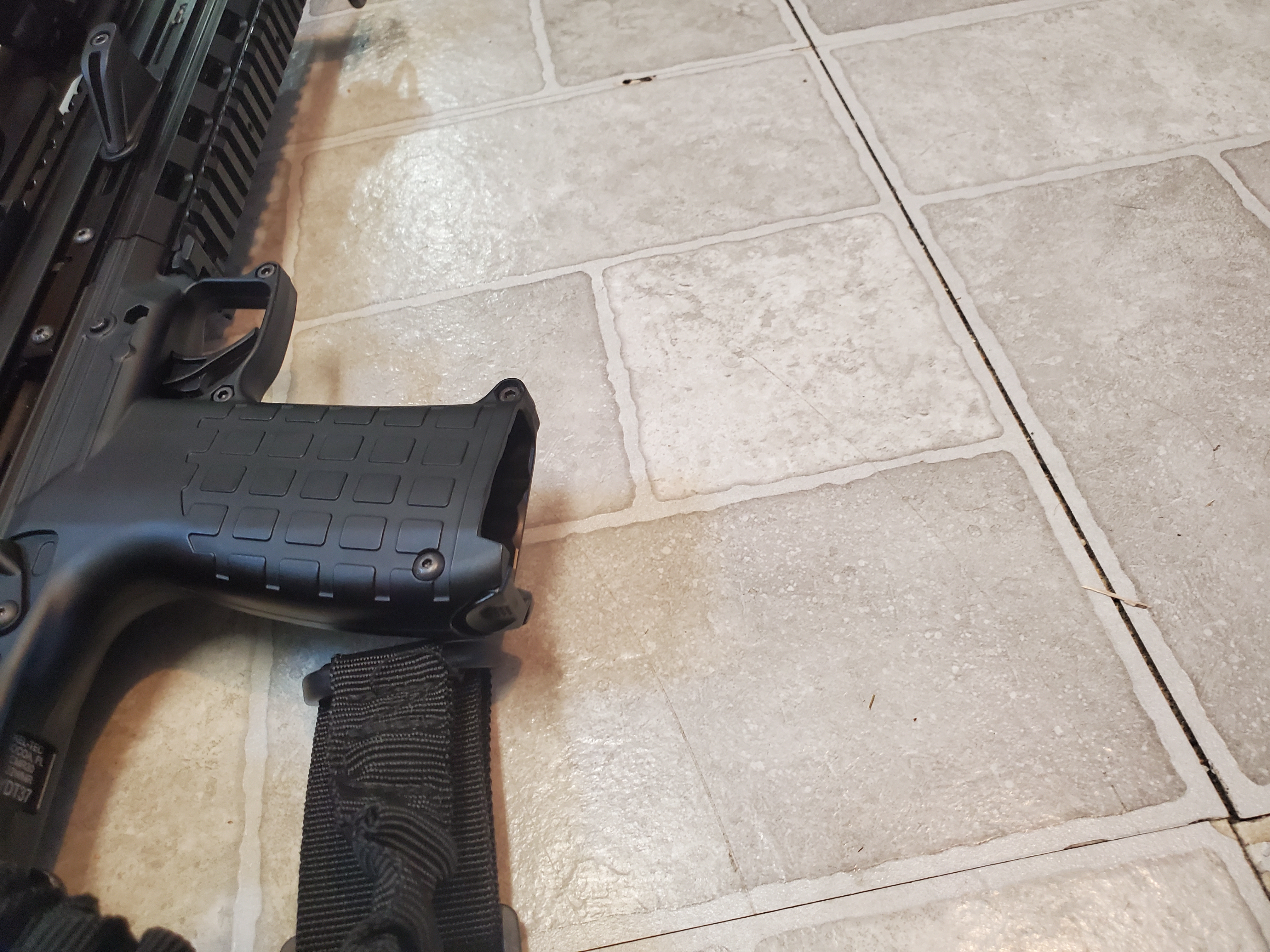

Was very easy to install and is recessed in but video says you should have a slight bit of play but none like it had well mine has no play I have to shove it hard to make surer it seats up in it there's no space between mag and grip have bumped it and mag fell out the first time I took it to range before shooting can someone from service tell me what is wrong or what to do to fix it. Ill redo my review if I can figure out what's wrong great workmanship and part though.
