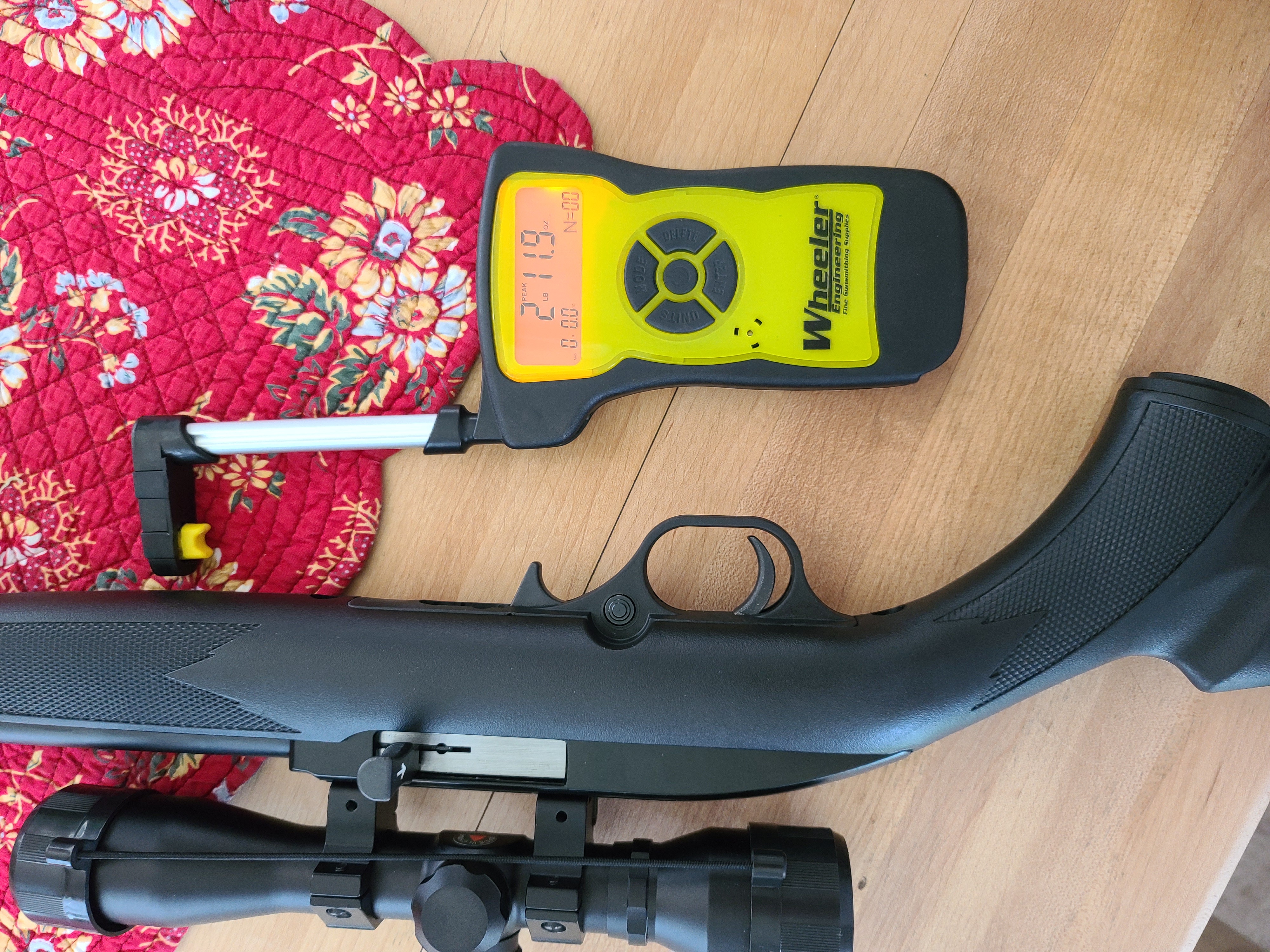

M*CARBO always provides quality products. I have four M*CARBO products on three different guns. And have ordered a fifth product for fourth gun. So no problem with confidence in quality. But after day two of trying to install this trigger spring. I would love to give the WTF salute to Mossberg and configuration of this trigger group. I have swapped springs on my Ruger AR556 trigger. Which I need three hands, but got that accomplished. But back to Mossberg 702 trigger assembly. Seriously WTF. Yes patience is a virtue, but everyone has their breaking point and this install is mine. Just to repeat this is not a commentary on M*Carbo and quality. Come on Mossberg SNAFU. Day 3. Project is complete. After polishing any contact point very impressive results. My goal of this project was to get trigger pull under 2lbs. From 5.3lb starting point. Wheeler gage and pictures don't lie. I was able to get trigger pull to 2.12 lbs. Worth the effort. Looking forward to installing trigger springs on SW Jframe 642.
