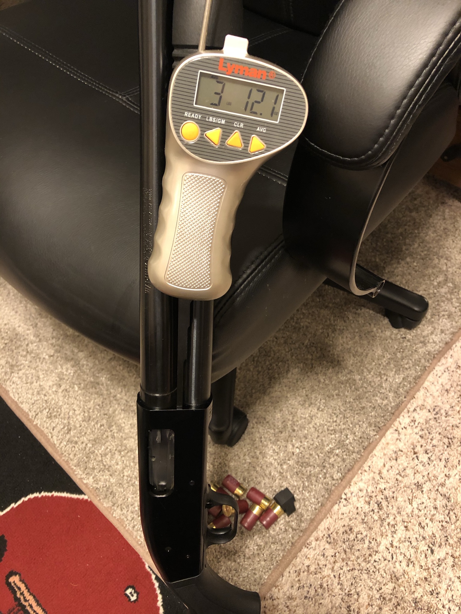

I installed this kit on my maverick 88 12 gauge. Super easy install and really a HUGE improvement in the trigger. Highly recommend this kit. Dropped the trigger pull from 6 #’s 15.4 oz’s to 3#’s 12.1 oz’s. That is 10 pull averages.
