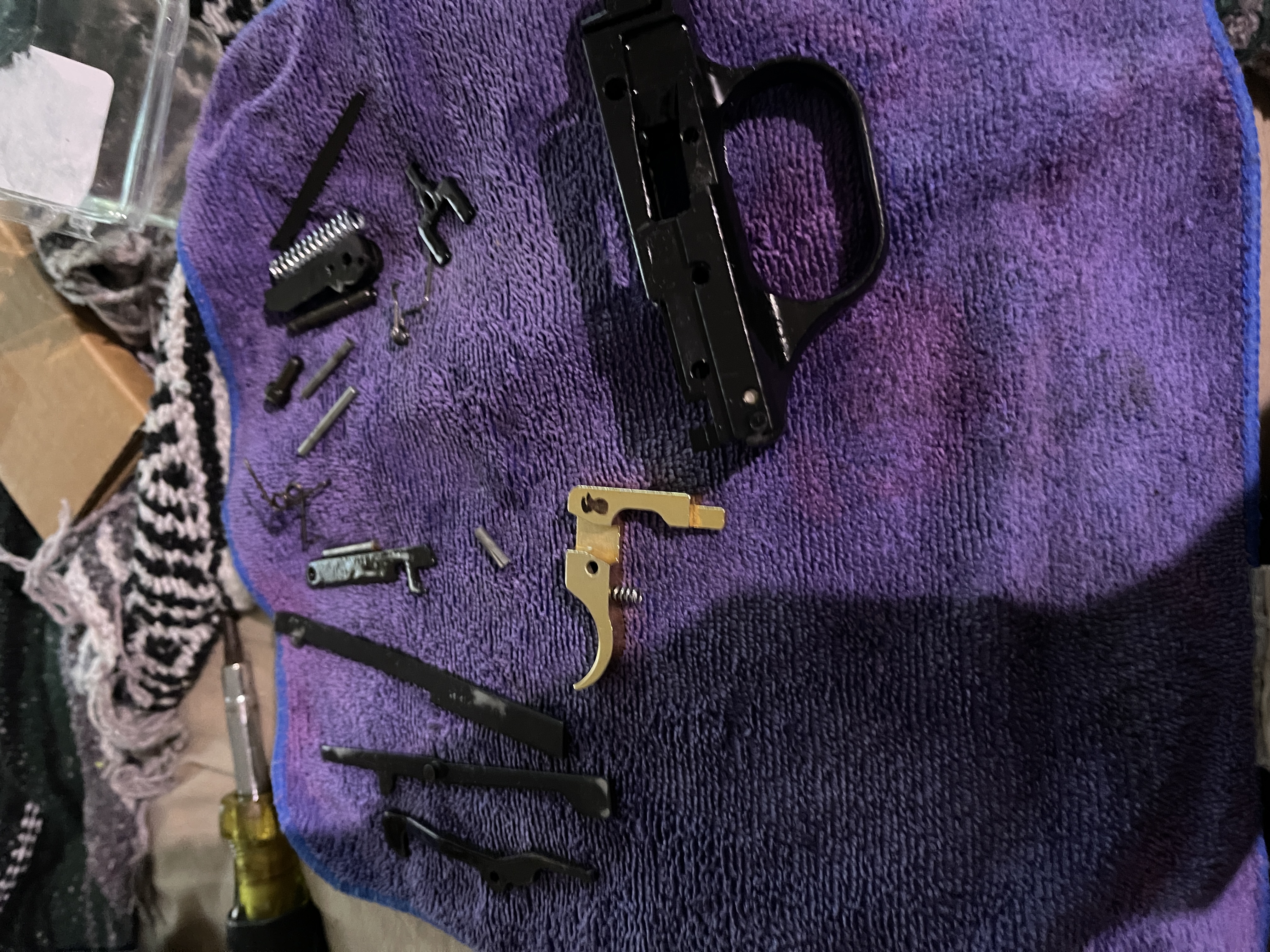

So basically I got this spring kit from here and a gold trigger from another vendor for my Mossberg 500A.
Backstory: the first time taking this gun down to clean in probably 20 years, this gun was recently inherited. It was manufactured in 1984 and I received it after non use for 20 years about a year ago. This is my first shotgun.
My report: The trigger in my 500 was noticeably heavy prior to install. I installed this product myself, I have taken guns apart and built AR variants in the past.
With a couple YouTube videos it can be done in a short period of time if you have taken this gun down before. I didn’t first time took the trigger group all the way down cleaned this gun and installed mcarbo goodies. Honestly they surpassed my expectations with this one. I’ve installed their kit on my ruger American I could tell a difference but this kit really sold me man. Good job y’all.
