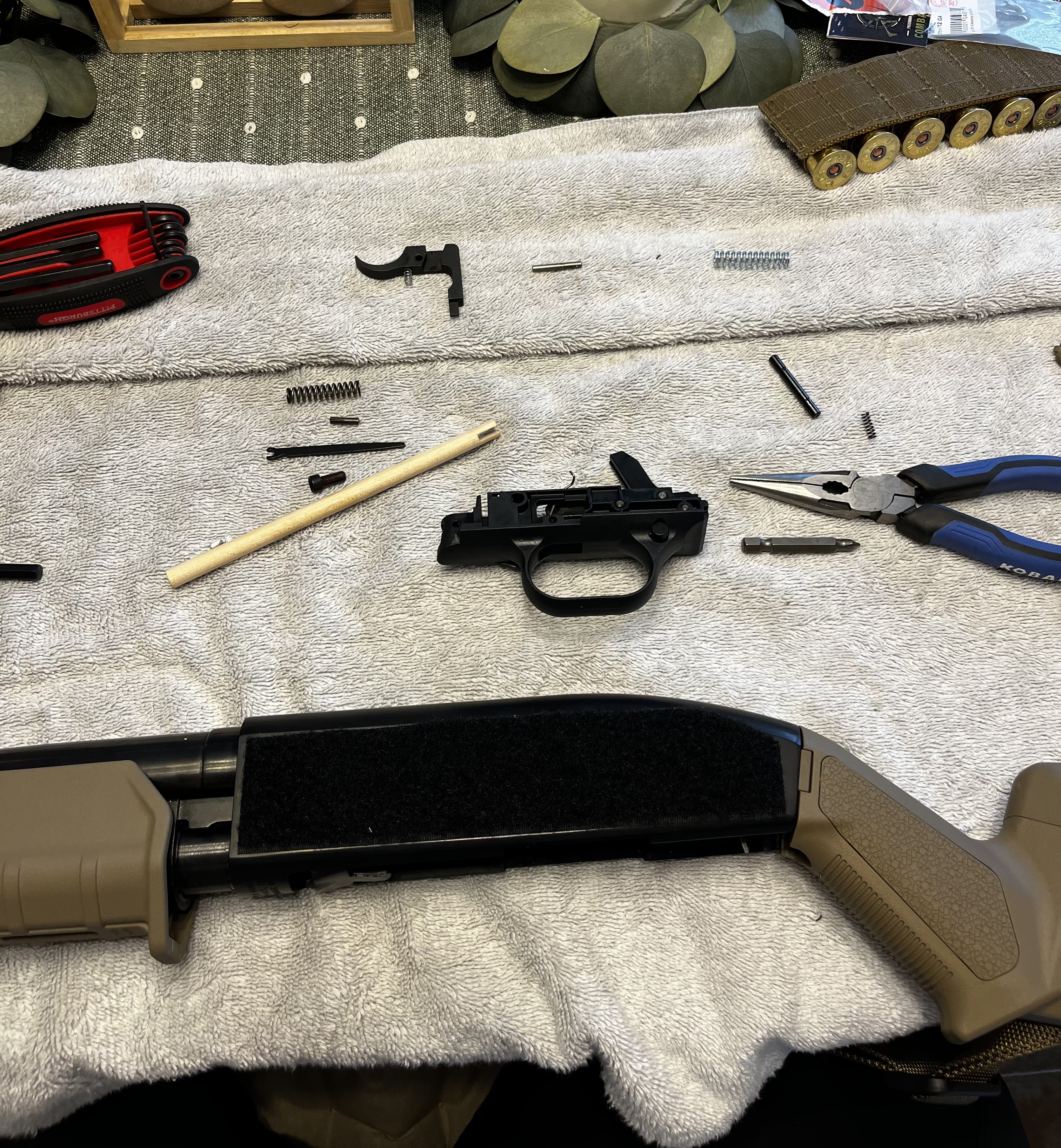

Installed the trigger spring kit on my unused new Maverick 88. The trigger pull out of the box was about 7 lbs. After installing the spring kit, it reduced to 4.5 lbs. I am sure that if I polished key trigger parts as I would normally, it would be lower.

Be careful on the 88, the disconnector spring is different and pops out when removing the trigger. The disconnector holds it in place when depressed. I also was not able to remove the disconnector because there was no clearance to wiggle it out. The trigger pin also holds the connector spring on the 88. It loops around the pin. Just look at it carefully before removal of the pin. Luckily I was able to figure it out but the video is a decent reference for how most of this goes together. As far a pull reduction, mine was very poor to start. I'm guessing it was close to 8lb.s and reduced it to 5 lbs. it was an improvement from the factory pull.

Overall I am very happy with the new springs. My trigger pull went from an average of 6.6 to an average of 4.10. It took awhile to install the springs. The Maverick 88 is different then the 500. I had trouble with removing the disconnector. It's not the same as the 500. Also it was not easy to get back in place and the spring took some work to properly locate. The wooden tool did help with the hammer spring.

the mav 88 trigger pull is so bad you think that the safety is on, not all the time but often enough, the spring kit is exactly what this shotgun needs, don't be intimidated by the replacement job, it is almost exactly like the mossy 500 viseo, only that there will be a spring with a funny bend in it will pop up, it won't go anywhere it just pops up when you pull the trigger out, now that funny bend goes straight below where it popped up from, a small flathead screw driver will push the spring arm down and then it will seat into the trigger housing, just look at it and this will make sense, other than that the return spring needs to be started sqaure not crooked, I mean push it in square to start the trigger assembly back into the housing, long winded I know, just trying to help, easy peasy, you got this

The trigger spring works great as advertised lowered the pull a good amount. I don't have a trigger pound gage but it feels almost half. Now on the install it was a not easy like the M-Carbo video on the 500. In the comments they said they would do one for the 88 but I could never find one. Overall it works but I would defiantly find a good video of how to or I did see a computer animated one that showed how the 88 trigger works and that helped.
