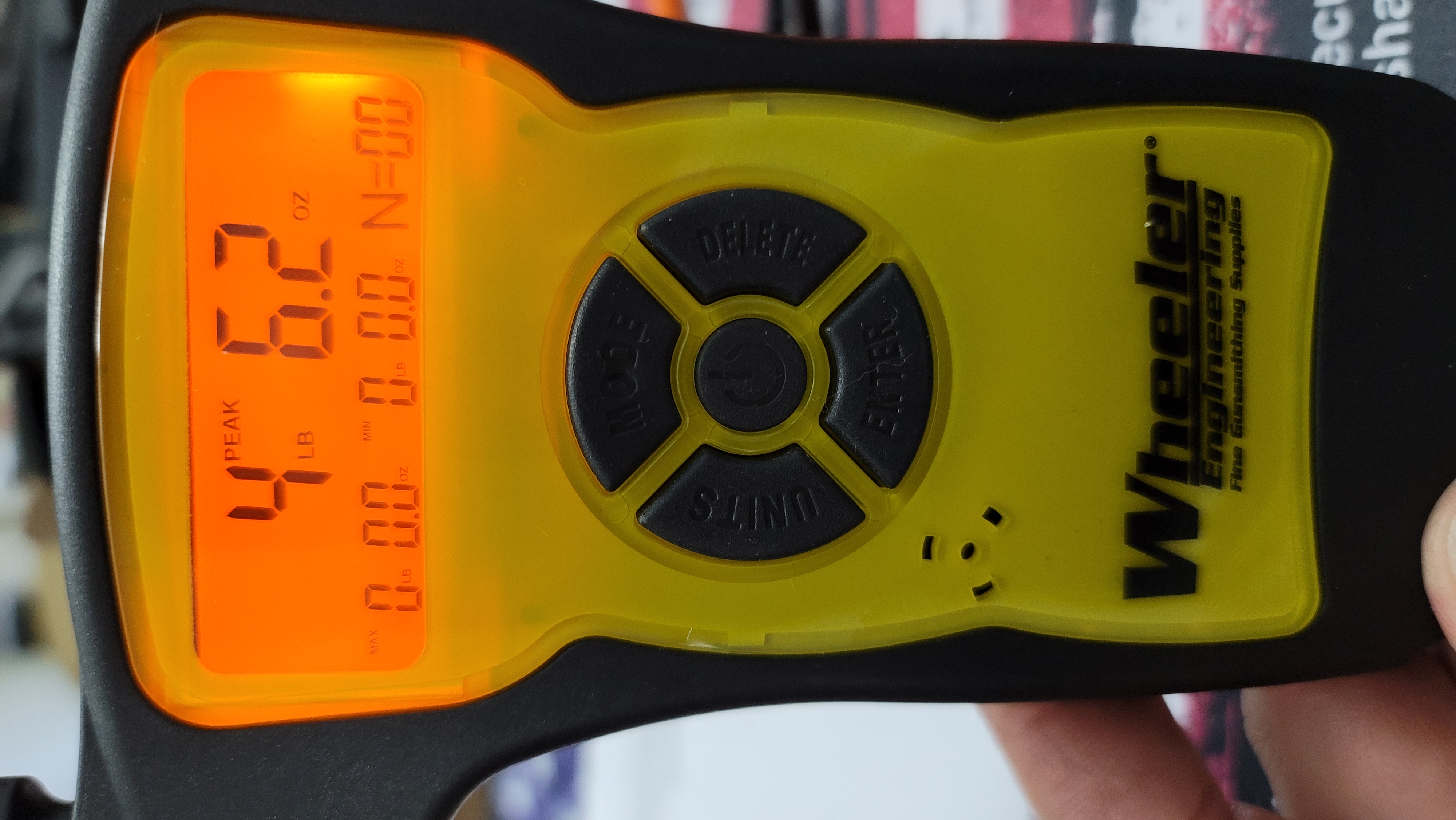

I bought the spring kit like 2 weeks ago or more. I wasn't sure if try them or just go with the Apex upgrade. But sometimes was screaming to my ear "try it"! So last Sunday late night I install it. For my surprise was very simple (with the install video). After I finish I check my trigger with a trigger scale and from 6.5 lbs went down to 3 lbs.... What 😳. It's a beautiful mix of a really nice defined wall, a really crisp break and a really good reset. Then I went to the range and try 60 rounds at 10 yards. The big holes was slow shot, the head shot was at 12 yards away. And yes, I only shoot one. And the rest was rapid fire. If not a great group, but it is really good. Just Iron sight. (I can't find the holosun 508t v2 anywhere. But my final impression is... BUY IT! Test it. And then you decide if you want the full upgrade. Maybe I will do the full upgrade, but not in the near future. That good is it! Again, just buy it!
WOW!!!
From 6.5 lbs to 3 lbs. It's like a new gun. I shoot this at 10 yards. With iron sights. It's not a great group but, it's good. Again I can tell you how different (in a good way) this simple upgrade will benefit. Do I need an Apex trigger upgrade now... No! Maybe in the future, just for the flat trigger. So in my opinion do this upgrade first, then you decide.
