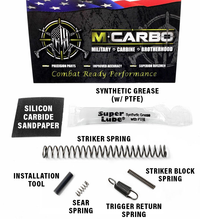

Some of the video instructions do not apply to the 2.0. 1. no take down lever spring in locking block like the 1.0 - so don't look for a missing spring. 2. sear block has a spring plunger and sear locator arm in the 2.0, not in the 1.0. Be careful when removing the sear pin, hold the sear down when removing your punch, or parts will fly. 3. the slave pin is too long , you will need to trim it down to fit, the slide lock arm will not slide over trigger asm with the Mcarbo slave pin in place. 4. take your time, polishing is the key to remove most of the grittiness. Springs will bring the trigger pull down, but getting any burrs or chatter off the friction parts is critical. Trigger pull prior to upgrade:5.5 - 6lbs, after 3 - 3.5 lbs. I spent a total of 6 hours, but had to find videos for the 2.0 sear block and frame reassembly. Also took time polishing, even more than Chris did. extra polishing: sear plunger head,bottom of sear where the plunger head contacts it. Polished the trigger safety plunger frame holes - both top and bottom of plunger travel areas. just basically anywhere there is friction between two parts. Be patient, this is a good upgrade.
MCarbo’s video makes this M&P45 kit look possible to DIY but don’t try it. I unexpectedly had to buy lots of extras and still couldn’t finish it myself. Had to buy rotary tool ($26), polishing bits ($6), Flitz ($12), gun punch/brass hammer kit ($32), striker block spacer ($13), and sight pusher tool ($39) because only it could budge the S&P M&P 45 rear sight. The OEM striker spacer is a thin metal disk that slips off the spring so I bought a plastic one with a thin nub to hold the spring but that quickly broke. Then I persevered for over 4 hours to get the metal disk correctly reinstalled or I’d have a useless pistol. At this point, I had 2 springs left to install but gave up. I could NOT punch out either receiver roll pins with any reasonable amount of force; and I feared if did remove them that I might not get them go back in. Besides my concern about having a gun I could not reassemble, I had already invested 8 hours making this upgrade, 2 hours of which were polishing metal, and didn’t want to spend another few hours polishing more parts. The parts and polishing I could do on the upper helped ease the trigger pull but may never know how the full upgrade feels. If I could had read this kind of review then I would have mailed my gun to MCarbo and paid them to do the upgrade. Don’t make my mistake…just pay them $95 to do it!

Ordered, received, installed and tested S&W M&P 9 spring kit... All within 12 days !!Trigger pull went from 7.3 down to 3.4 lbs.. Polishing made a big difference as well. The video provided by Nelson was over the top.. great information/instructions presented in an understandable way us humans can relate to. Other than my old 74 year old shaky hands the project went great !! Keep up the "kick ass" work Chris !! Thank your staff as well....
After looking around for a replacement trigger I watched the video on M-CARBO and decided to try it. The other option was expensive and did very little to improve the trigger pull. I didn't do as much polishing as they showed but mostly changed the springs. Trigger pull went from 7# to 4 3/4#. Since this will be used as a Pin Gun that will be perfect for me.
I purchased an M&P that was traded in from a police department. I followed the polishing and spring installation video precisely which was excellent. When I started to put it together I noticed that the sear spring was much smaller in my sear housing than the replacement spring. I had to use the original sear spring therefore I did not get as much of a decrease in trigger pull that I expected. Trigger pull Went from 7 lbs to 5.25 lbs. The quality of the parts were great but the results in this particular handgun was disappointing.

Just got my M&P .45acp and wanted a smoother, lighter trigger pull. Could not have done the swap, sanding, and polish job without the videos. Ninety-five percent of the video pertained to my model (2.0 version). A couple of features and procedures were different than the video....so....pay attention to the internal components of your firearm in the event they are different. End result is a 2lb reduction in trigger pull, and a much smoother, less gritty feel. This is my second trigger spring kit, and plans for another for my Ruger LC9s.
