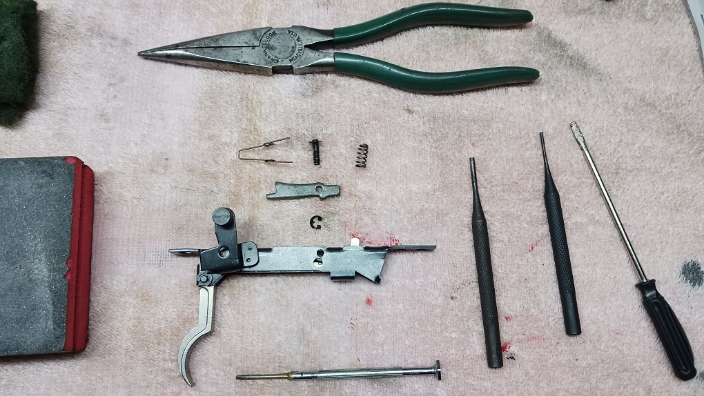

<p>I put these spring in but before I did that I sand and polish all connecting and moving parts then grease and reassemble. And with these springs it a night and day difference... I have three more buddies wanting me to do the same to theirs now... great product!</p>

Super fast delivery. Started with 4.5lb trigger pull. I followed the mcarbo how to video w/o a problem, however the mcarbo the trigger return spring (TRS) shot off into the spring black hole and had to reuse the OEM spring. So, use caution when installing TRS. As a result I reduced the trigger pull to 4lbs. Hint hint, I could use another reduced trigger spring. Thanks mcarbo for super fast delivery, a reasonable price kit, and easy install instructions!
Fast, Easy Upgrade.
It took longer to disassemble the rifle than to do this springs upgrade kit. My trigger's pull went from an inconsistent 4.85 Lbs. pull to a more clean and crisp 3.35 Lbs. predictable pull. Accuracy for a 10- shot group improved by about 0.75MOA at 50- meters. Excellent product. Recommended.
