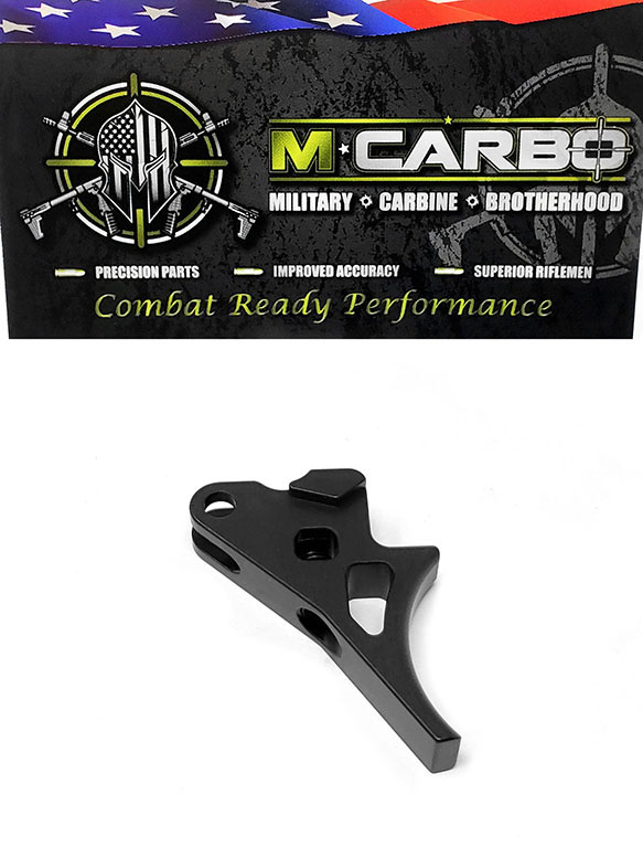

KEL TEC KS7 Trigger Upgrade Introducing the ultimate KEL-TEC KS7 Aluminum Trigger replacement by M*CARBO! Unlike the factory plastic version, our trigger doesn’t flex, ensuring consistent performance. With proper adjustment, it features zero...
