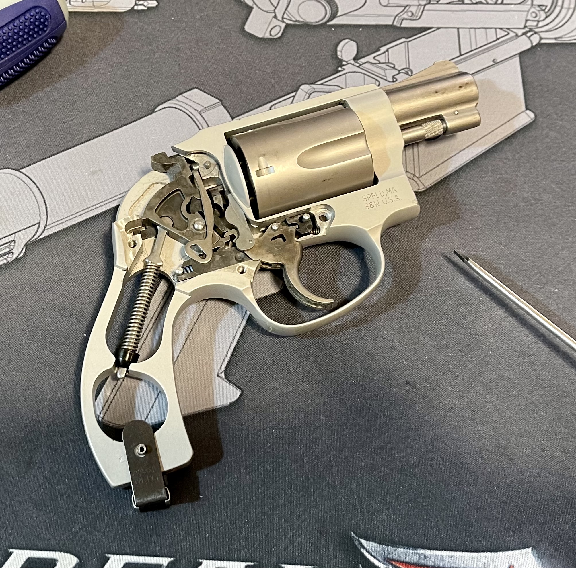

This was the closest to gunsmithing I’ve ever been. Opening up, cleaning and parts replacement on AR-15 was really all I’ve tried. But the job was supported by the MCarbo YouTube video that made it a snap! I added a good q-tip cleaning but otherwise this kit was all I changed. What a difference! Now my S&W 638 is at least half lighter pull, should really help grouping controls. Thanks MCarbo!

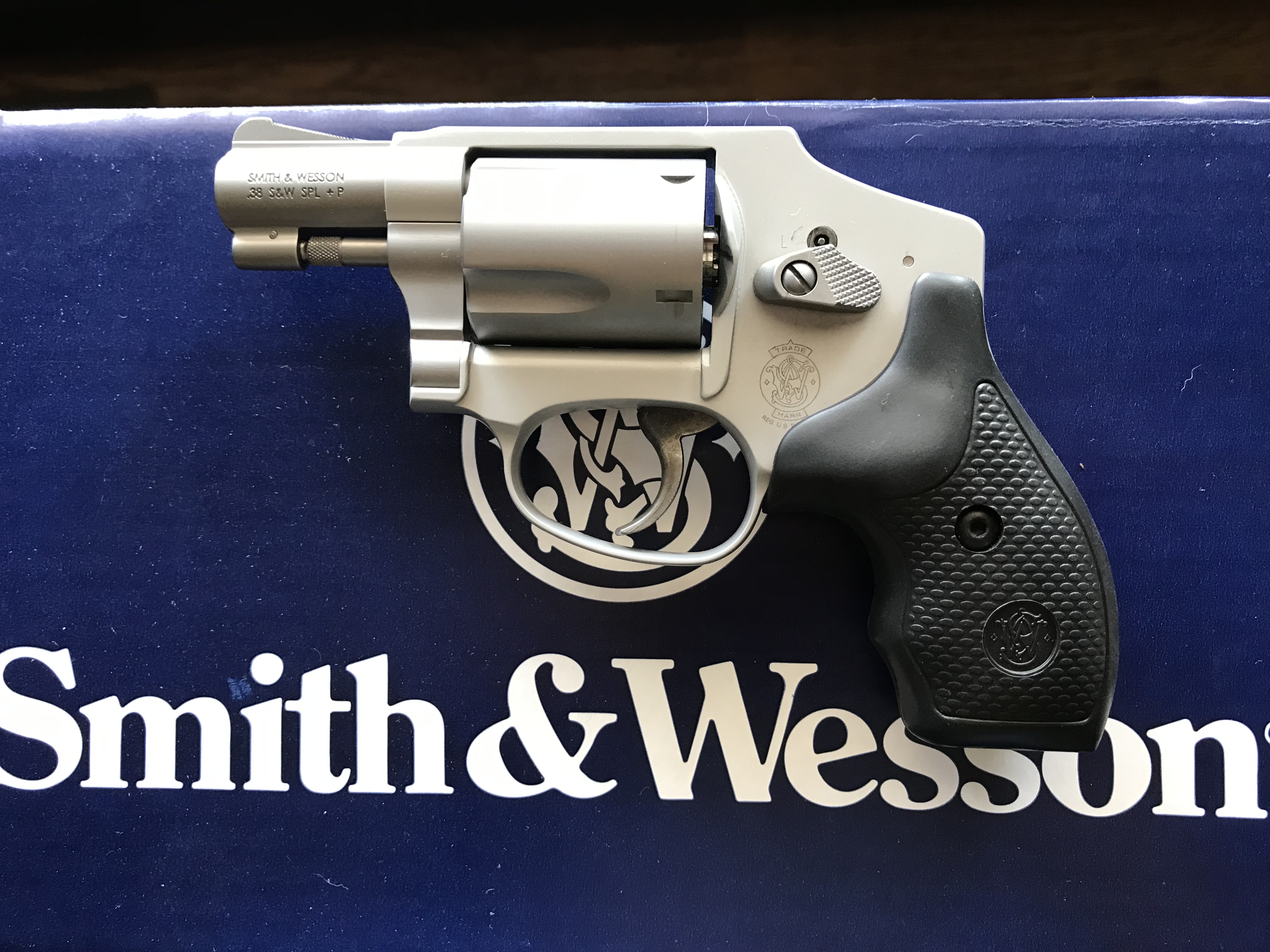

Smith & Wesson 642
I received my spring kit fast; I installed kit and found the trigger spring too weak to return trigger properly at a slow pace. I reached out to M*CARBO and they sent a new spring fast and free. I installed spring and the trigger works flawlessly.

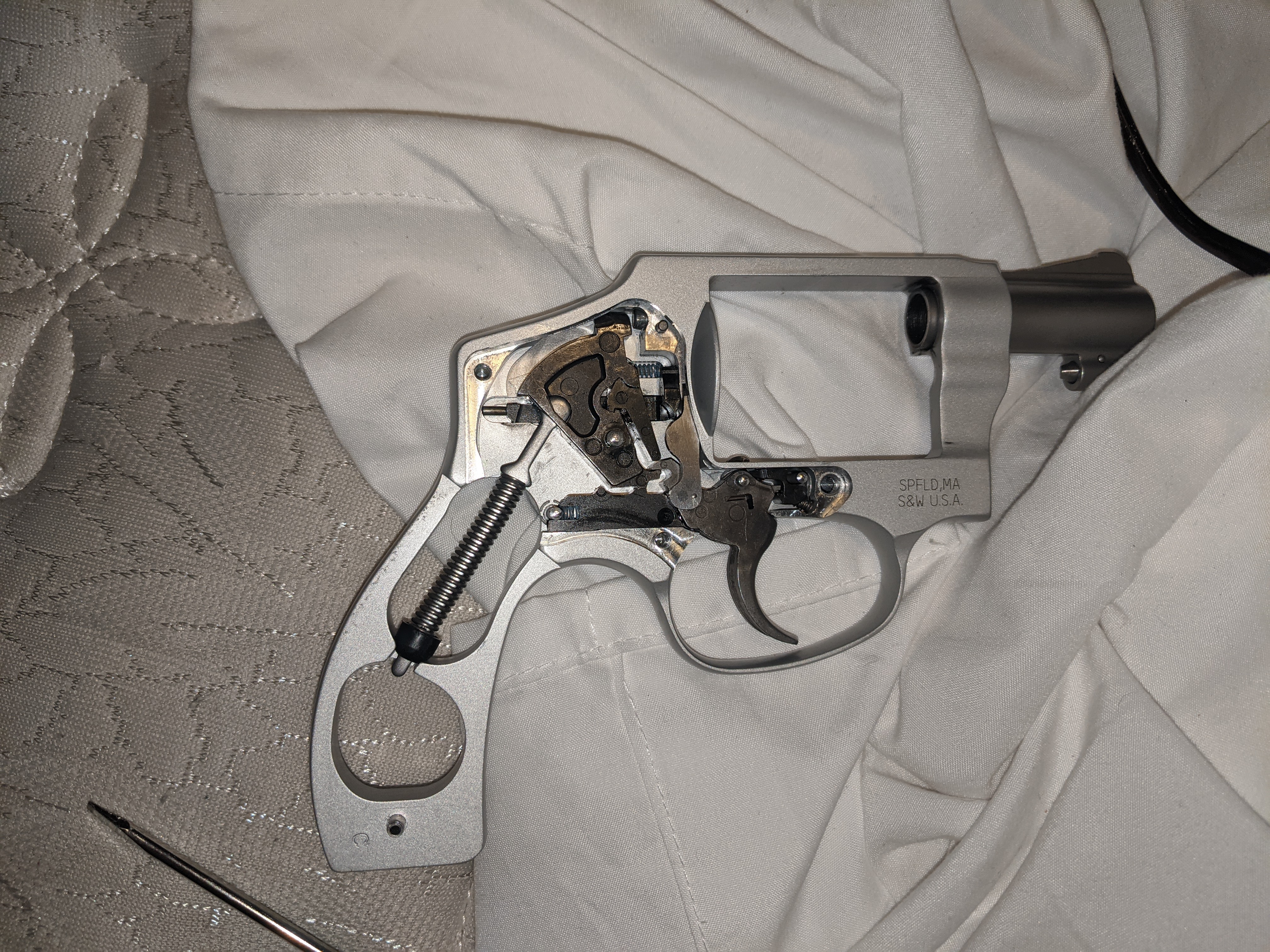

Replaced hammer spring first. Changed from approximately 9.5 to 8 lb double action pull. It changes single from 3.0 to 2.3. I did not change the trigger spring, that was light enough. I figured it would change a little. Good springs. Fast delivery. Thank You.

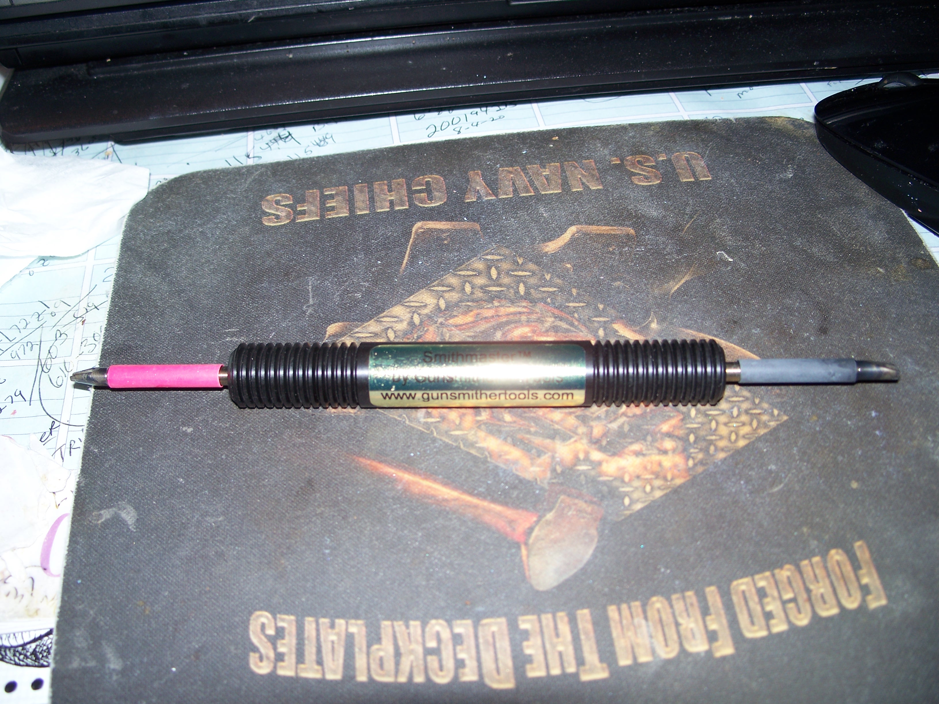

Wow! Went from 10lb 1.5 oz in double action to 3lb 28oz.
Single action from 3lb 28oz to 45oz! I might have to put back the original trigger return spring as this is really light in single action, but realllllly nice in double.
I used a Wheeler Professional Digital taking an average of 10 pulls each time.

Very easy to install. It only took a few minutes changing out the springs. The you tube instructional video was very helpful. The trigger squeeze is so much better. Have not fired it yet but I can already tell a major difference in the gun.
