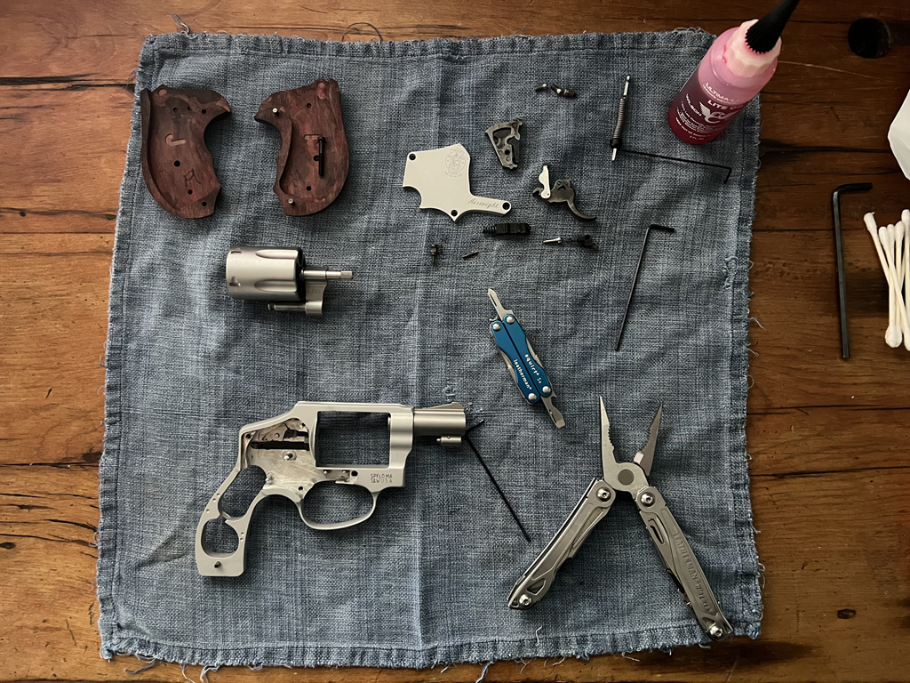

Look, the 442 J-frame is a beautiful CC revolver, but with an Achilles heel; 10+ pound trigger pull (some find +=12 to 14#...ugh!). My wife needed LH index finger overlapping RH index finger to pull it anywhere close to steady. This fixed that issue for her...and, I can shoot it more accurately as well! But, do yourself a favor, add the little MCARBO bench block to your order, gather your other tools and spread them out in front of you and watch the video carefully, stop and replay as needed. It makes the process safe, easy, un-scary AND QUICK. Without the excellent video and proper tools...it is a potential nightmare, i.e, visualize hands and knees looking for spring in a haystack :-) A wonderful product offering 6-lb pull, reliable hammer/pin function and maximum accuracy. Buy this one!!!

Trigger feels much better and smoother. Had a heck of time gettin the long spring back on. A small tool to hold the spring cap and allow two fingers to compress the spring would be helpful. Just a piece of plastic with the right size hole

Well-made product and shipped quickly. I couldn't have replaced the parts without the great video. The trigger pulls in both my revolvers were decreased, which immediately increased my accuracy. One thing: make sure that paper clip is firmly in that hole or you will be searching for the spring and the little black doodad!
