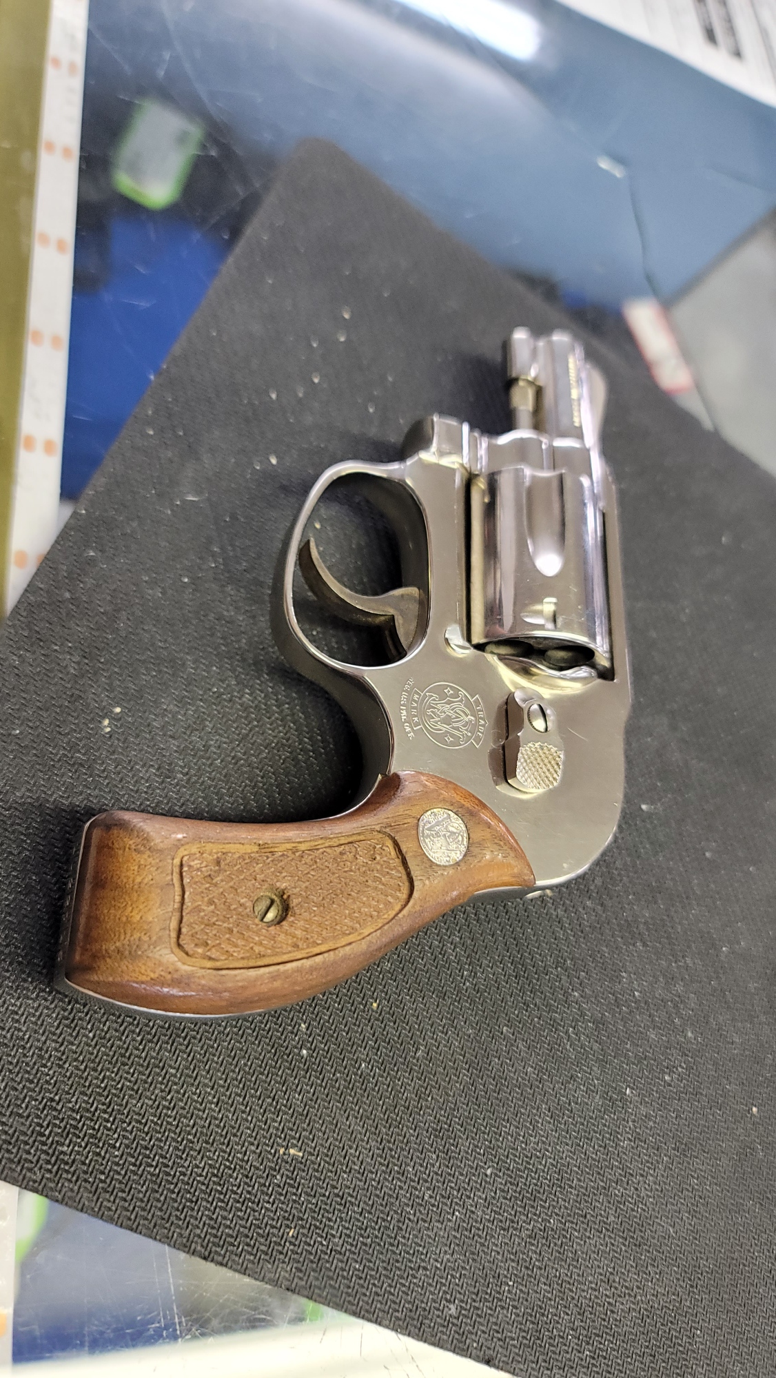

My trigger scale would error out because the trigger was so bad on my 80's Model 60. I installed this kit and brought the double action down to just under 9 lbs and the single to 2.5.

Big improvement on my trigger. Video doesn't mention the hammer block I have in mine, that is not on all models, but I took a pic after removing side plate, so no problem
