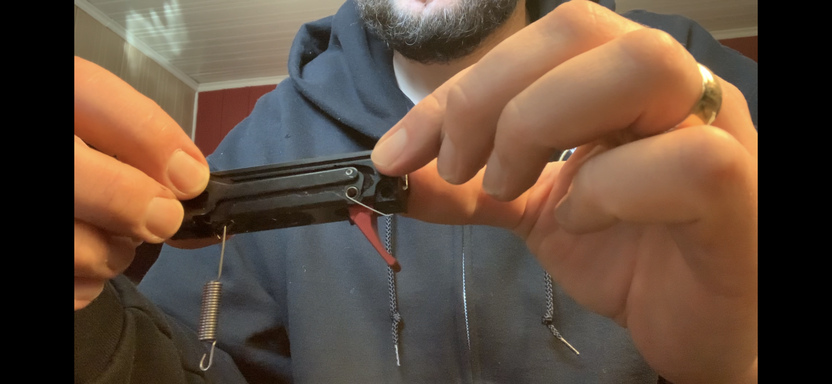

Ruger LCP Trigger Spring Kit Upgrade your Ruger LCP with the precision-engineered M*CARBO Trigger Spring Kit — designed to reduce trigger pull by up to 50%. This is the ultimate performance upgrade for shooters seeking tighter shot groups and...
