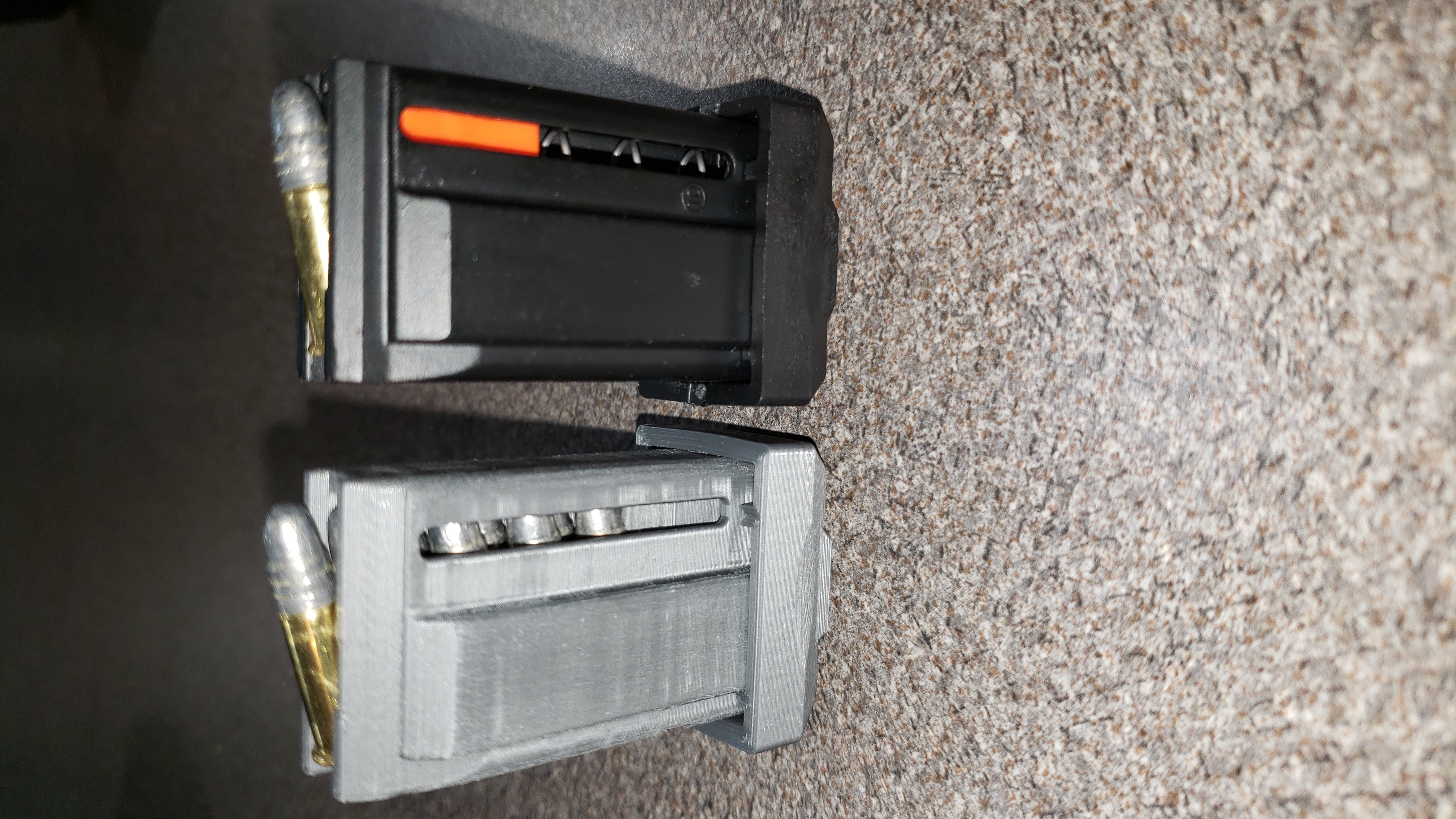

What's more, after seeing the price of new magazines, I found a free STL file online of the Remington 597 magazines. Downloaded the file, then sliced it with a slicer program and uploaded the file into my 3D printer.
I 3D printed my own magazine with ABS filament and installed this MCarbo spring. Wow! Feeds flawlessly after a little sanding.
The price of a 597 magazine is ridiculous and I just created one for the price of the spring! The best spring on top of that!
*1st pic: the 3D printed mag on the left, new mag on the right

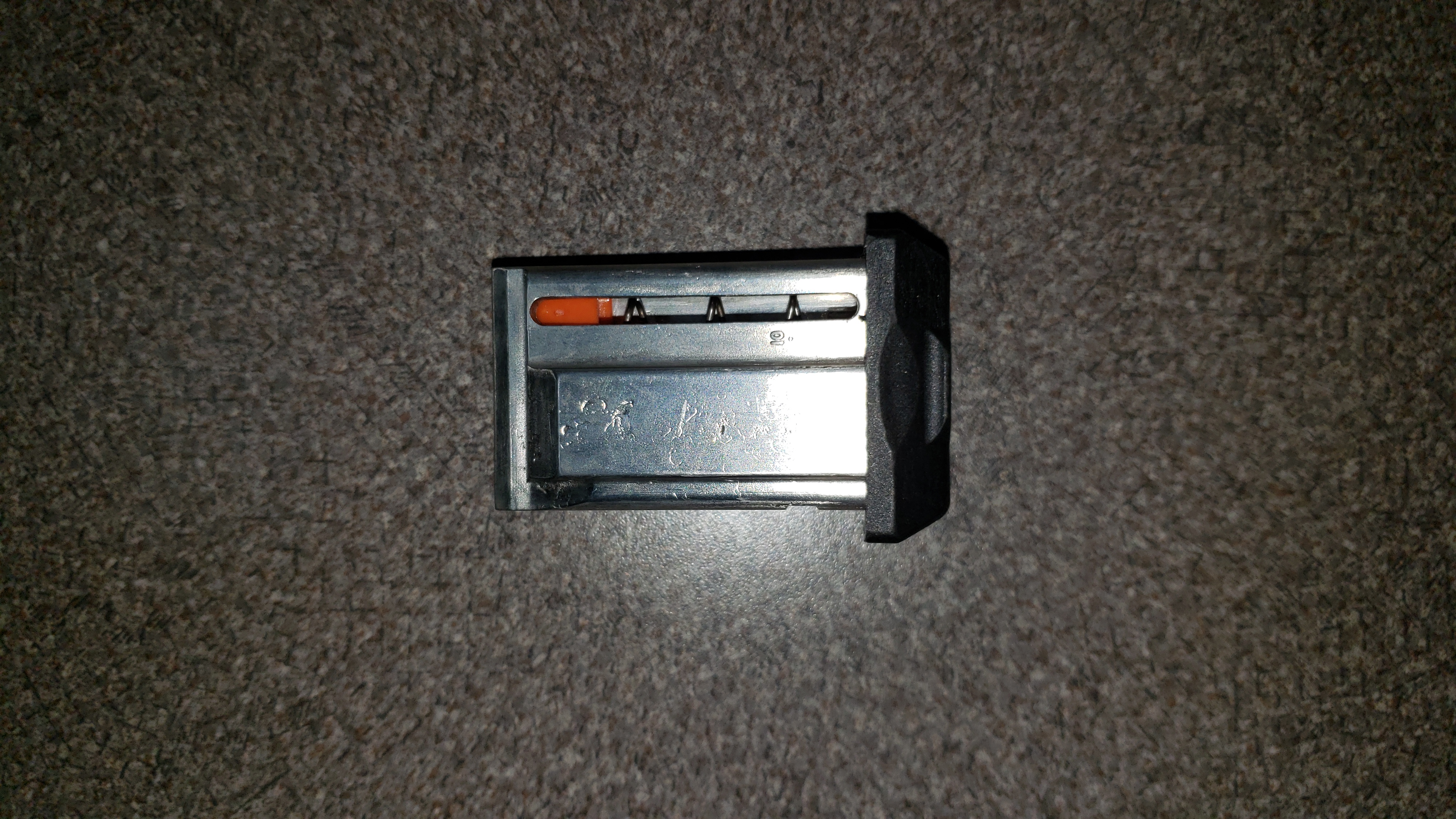

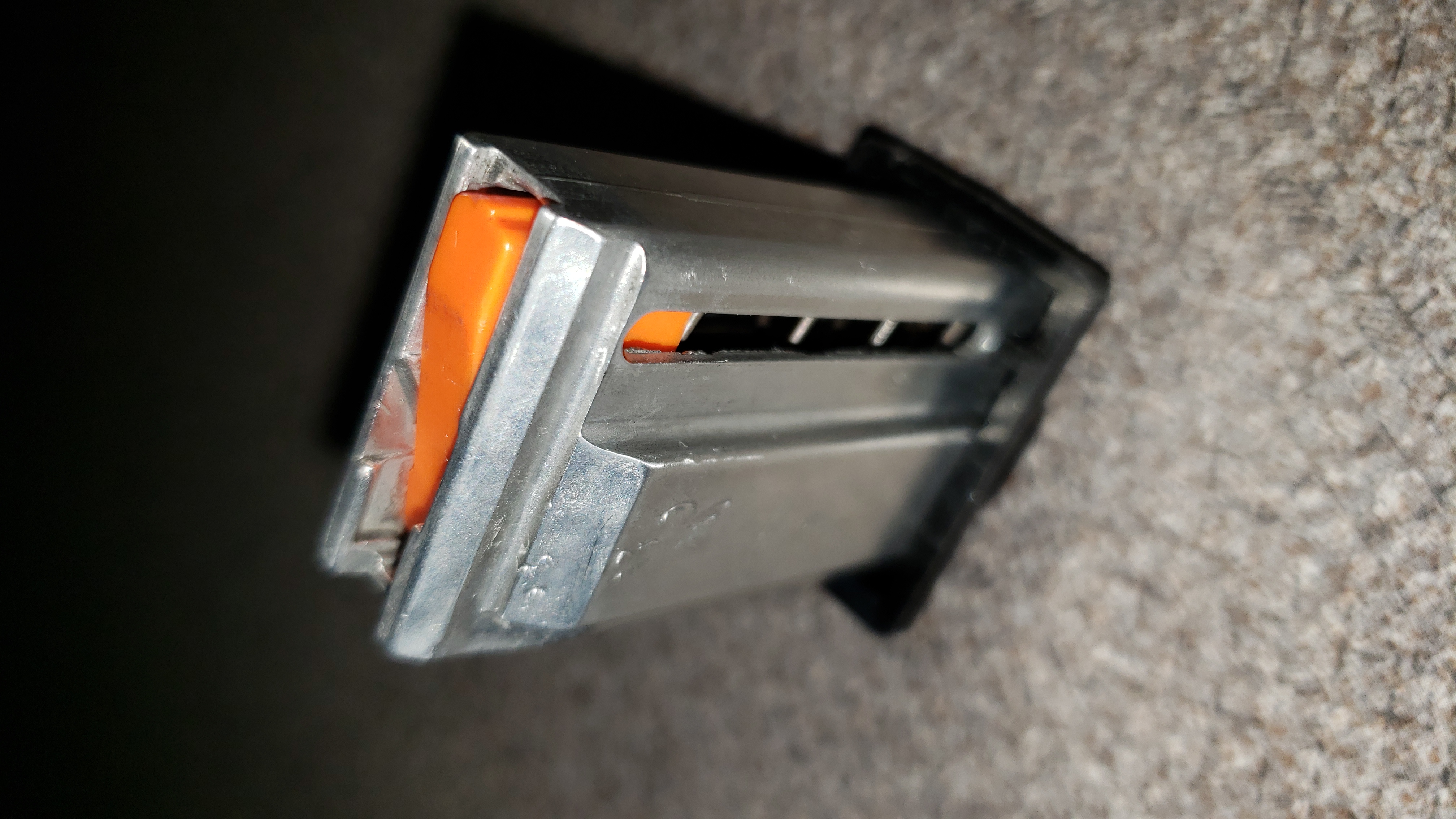

*2nd and 3rd pic: old factory mags cleaned up with MCarbo springs installed
