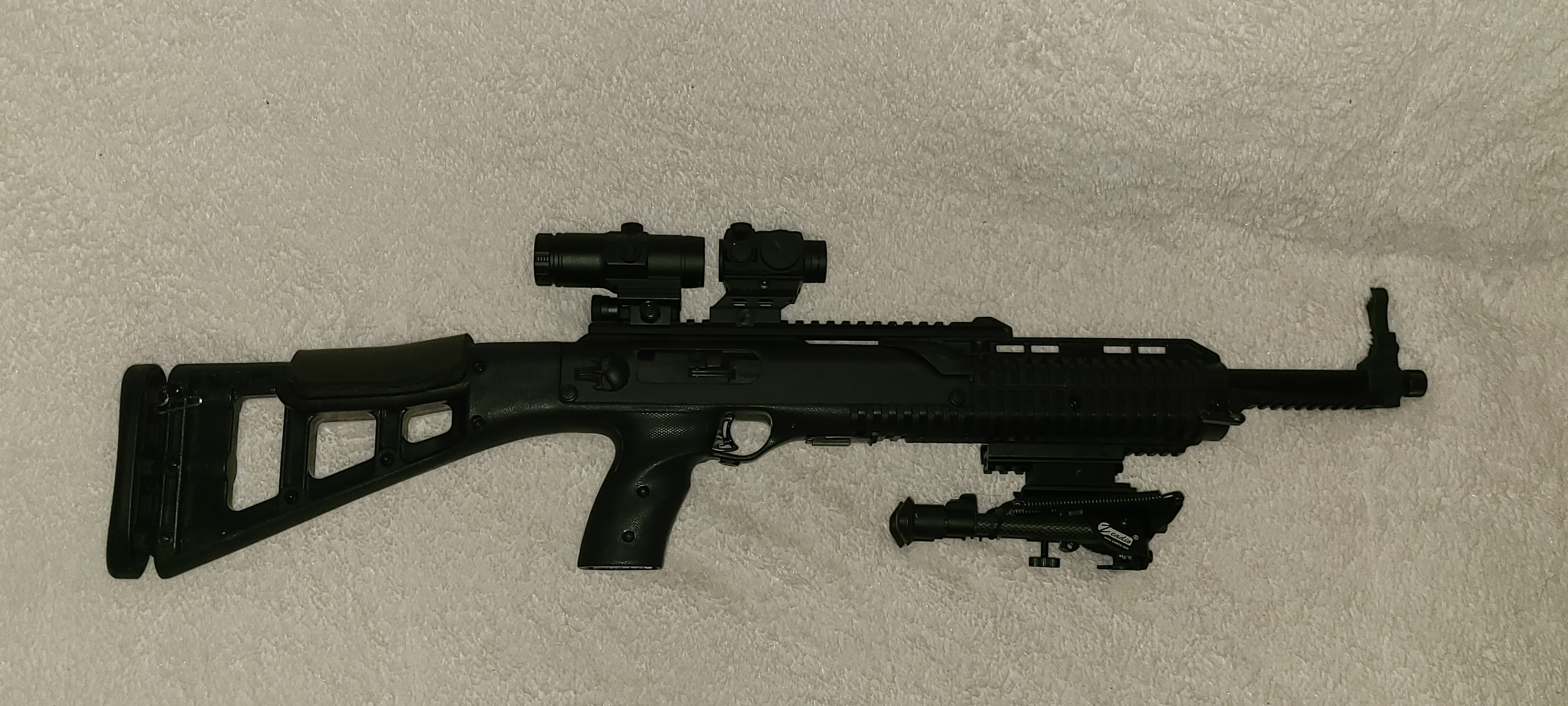

Upgrade your HP Carbine with M-Carbo
M-Carbo has taken a pretty decent 10mm (My only Hi-Point; and now my favorite carbine) and made it a great 10 mm carbine. The actions and fluidity of the spring, guide rod, and trigger spring kit rightfully skyrocketed the value of my gun.
The 10mm 1095TS groupings are phenomenal with the m-carbo kit. The trigger breaks cleanly. The charging handle has some strength to it, but my 12 year old nephew was able to charge it by himself, so it isn't difficult to load. It cycles a helluva lot better than what it did with the factory springs and plastic guide rod.
I had a bad experience with 2 types of ammo; PMC Ho.Po. and Remington flat. They seemed to be all over the place (this was my first test of the M-Carbo springs and rod). I was worried for a moment, but then I changed my ammo... and my groupings at 50 yards were within an inch.
My Sig Sauer 180 gr. fmj are my go to plinking ammo and they do not disappoint (well, my wallet gets hit hard as hell).
I also use the Underwood brand anything. They are my go to for self defense and hunting. Hard cast is just as good as the xtreme penetrator at half the price.
Get the kit, guys. Only problem I had was the cheek pad. I need a new one because the heat made mine come off (100 degrees outside when it started coming off).
