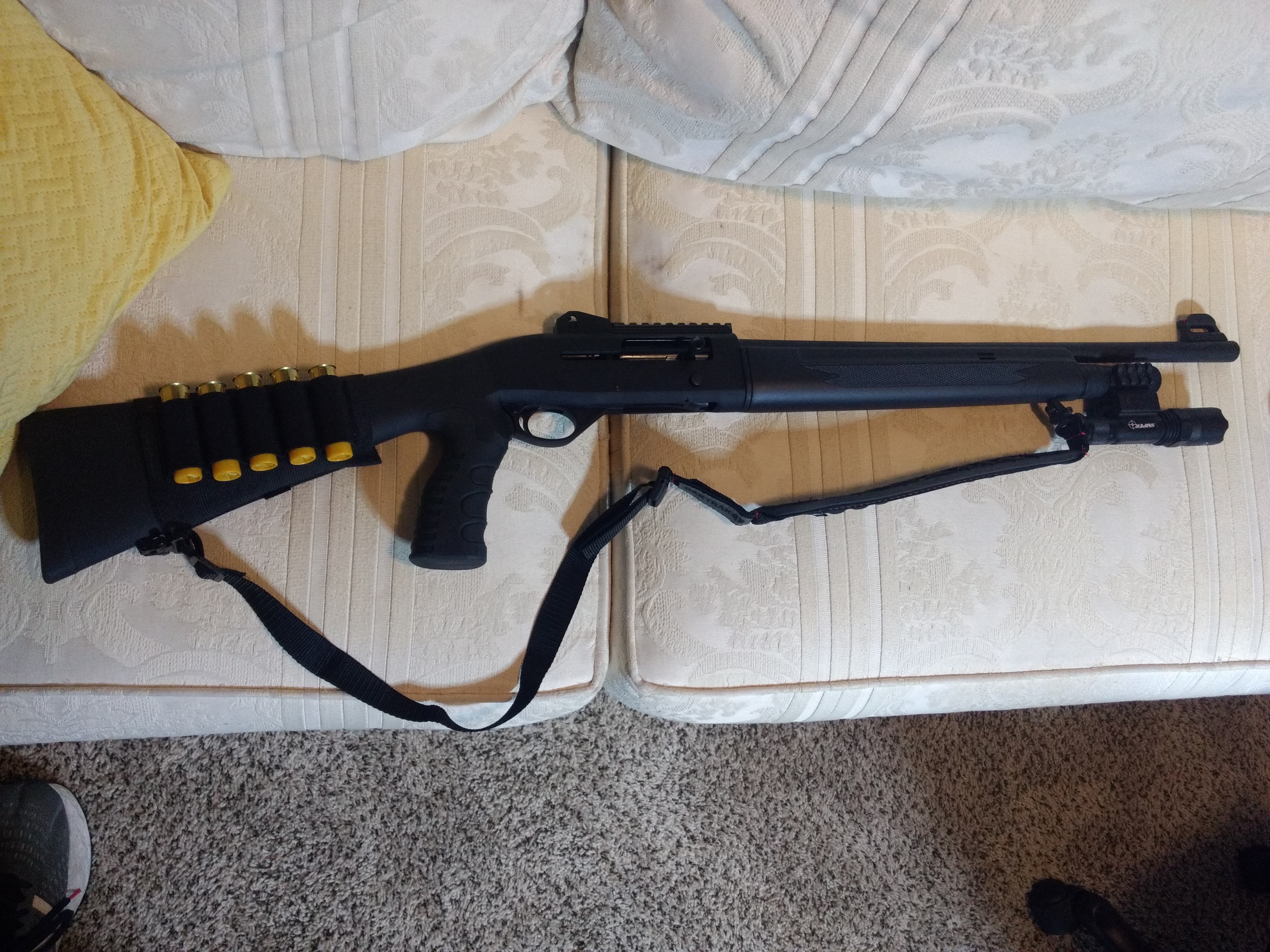

SA-20 Tactical
Installed the spring with no problems. Watch the entire instructional video first as the removal of one trigger piece is not shown but its reinstall is shown. I did the spring install without removing the it. Trigger was much easier to pull. Brand new shotgun and have yet to fire the first round. Trigger is ready though.
