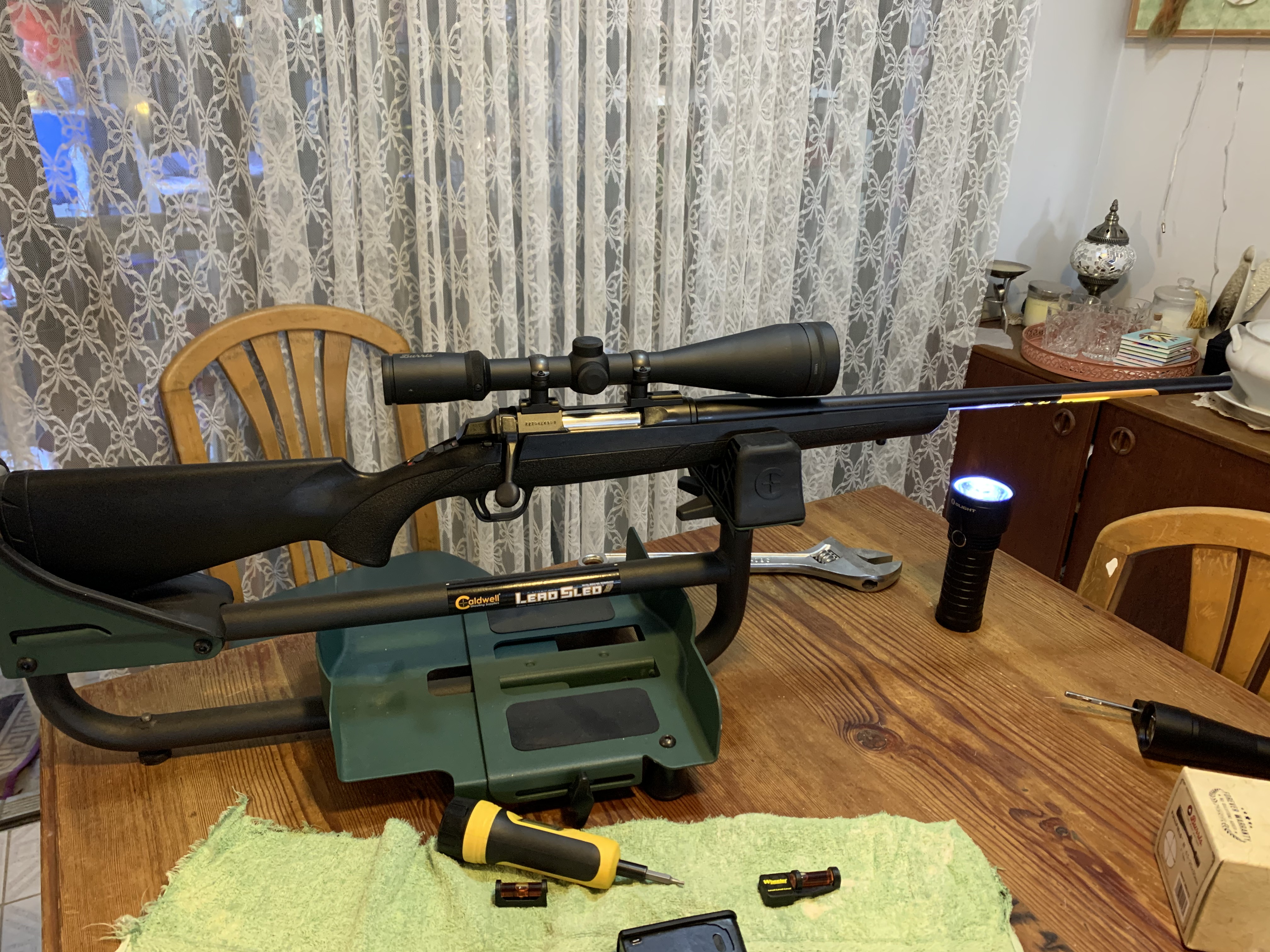

Before installation Browning AB3 Trigger Spring Kit, I measured in my Browning AB3 Composite Stalker the trigger pull was at 3.5 lbs, not 4.25 - 4.5 lbs as in the site video in the site description. Measured by Lyman 7832248 Electronic Digital Trigger Pull Gauge. After installation Browning AB3 Trigger Spring Kit the trigger pull became 1.4. I shoot at a range and like this trigger very much now. Easy install. Last week I have hunted Russian Boar and get him down with one shot.
