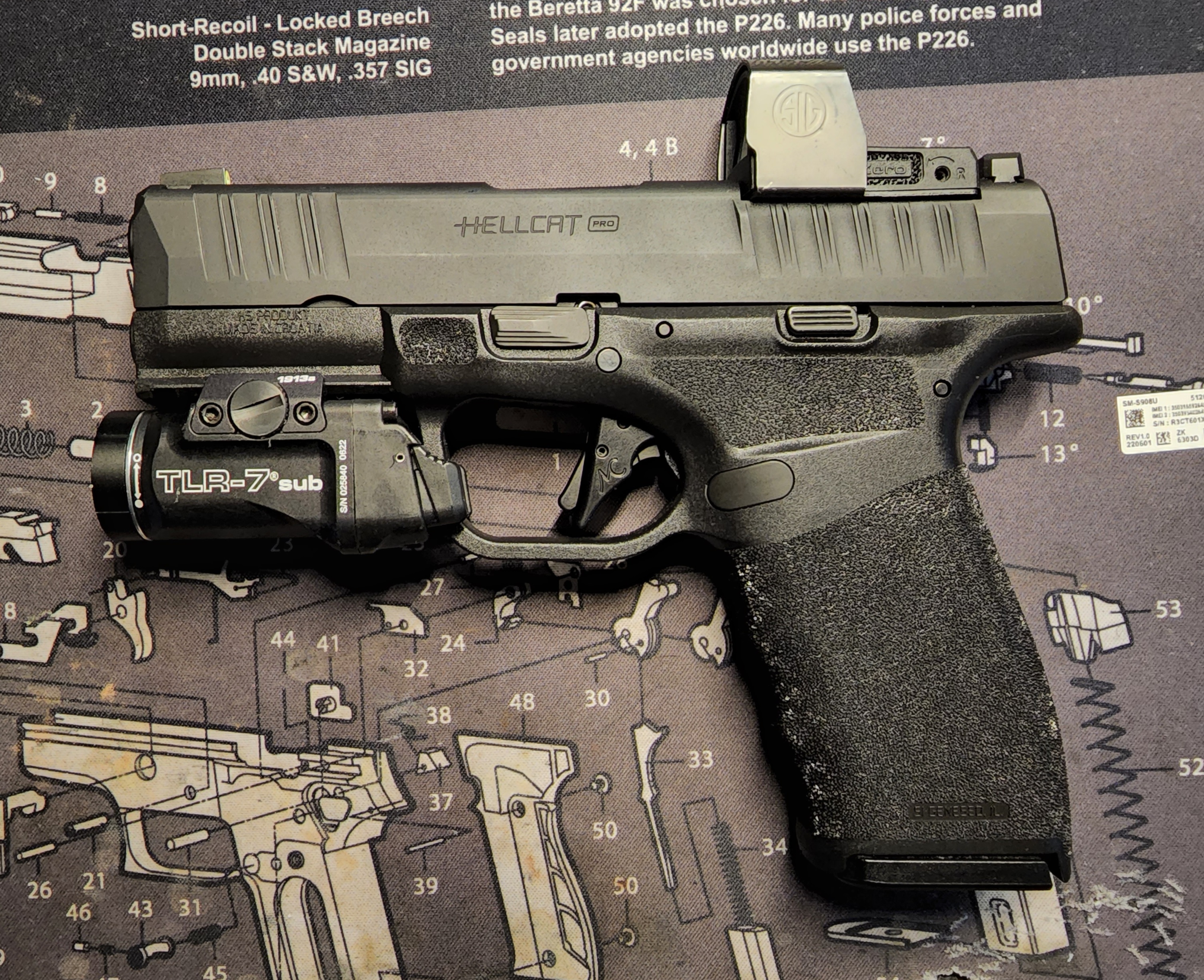

Dropped my Hellcat's trigger pull from 6.5-7lbs down to 4.25-4.5 lbs. When I had the gun apart, I used the polishing kit to buff any wear/contact areas. The gun definitely feels smoother and nicer now. Thanks.

Installation is very Glock-like, if you're familiar with those you can do this no problem. MCARBO has a fantastic (seriously, probably the best installation video I've ever seen) installation video if you're unfamiliar with striker fired pistols or just want to make sure you do it right. My Hellcat went from a heavy, wildly inconsistent trigger (6.2-7lb) to a much nicer 4.5, and it's 4.5 every pull. The consistency improvement alone is worth the money, but the reduced pull is greatly appreciated as well. I've never been a fan of heavy triggers, even on a carry gun. 3lb would be great but 4.5 is definitely fine. Worth every penny and I'll definitely be shopping at MCARBO again.

I was able to install the kit in my pistol the day it arrived thanks to the excellent video showing how to make it happen. I did polish the sear, the contact areas of the firing pin safety and the disconnector sliding areas. I also polished the inside of the striker sleeve because the tooling marks seemed to be raised enough I believed they might interfere with the striker some. That may not have been necessary but just being thorough. My pull weight dropped from about 6.2 pounds to a very consistent 4.5 with a solid break and quick reset. Major improvement in feel and I know this will help me to shoot more consistently. Great product.

The installation was smooth and I was well prepared from the provided video. I love watching the installation videos for all of the M-Carbo products as they are detailed and thoughtful to the end-user, not just a "I checked the boxes on things to cover". I also purchased the aluminum trigger shoe. Together the combination (after polishing) is a smooth 4.5lbs with a super pre-travel thanks to the adjustable shoe. All of the parts are well constructed with the same care that goes into every M-Carbo product. Hopefully I can get the upgraded striker as well, but right now it's made a world of difference with my Hellcat Pro!

Would not have attempted without the video. Made the install along with your new trigger. I'd say it's easy thanks to your instruction but it does take some patience and a time out or two to vent any frustration. I also polished the parts you suggested. I finally found it much easier to install the sear spring to the pin before connecting the trigger bar to the sear. I'm getting low 4 pounds on my crude little Wheeler gauge but more importantly it's an extremely smooth pull to a solid wall, a crisp break and a much improved reset. Well worth the investment.
