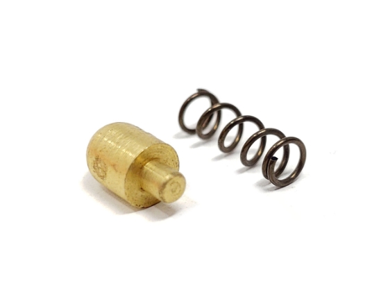

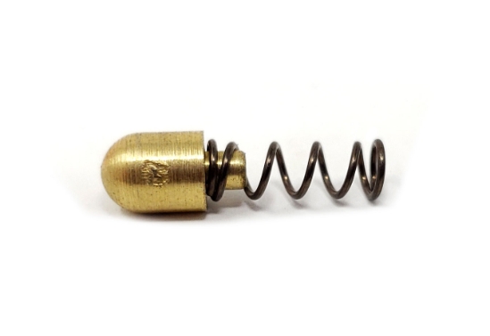

S2K-269: Safety Pin for SUB2000, all models.
2 different safety pins will be sent out. The larger pin will NOT fit in the older style safety.
  • 1 - Larger Brass Safety Pin for Gen 2 & Gen 3 models
  • 1 - Smaller Brass Safety Pin for Gen 1 and early Gen 2  models
  • 1 - Safety Pin Spring
KEL-TEC SUB-2000 Gen 2 Safety Pin and Spring Replacement
    Part number 264 & 269 on Exploded View
